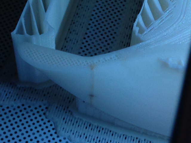

There seem to be more issues with the current Ultrat profile.
I'm printing a larger part right now with normal speed, 0.19, and Ivory Ultrat and the seam is brown. Only the seam...an nice brown line over the whole part....everything else is beautiful....no other brown spots.
Could it be that the newly introduced slower perimeter speed (to avoid ghosting) is a bit too slow when doing the seam movement?
Nozzle is almost new and was very clean when starting the print.
Did anyone else see this?
I saw. (quite the same...)
This looks much worse than mine... I only have a brown discoloration...the surface is perfect otherwise.
