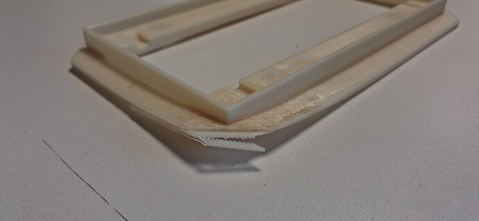

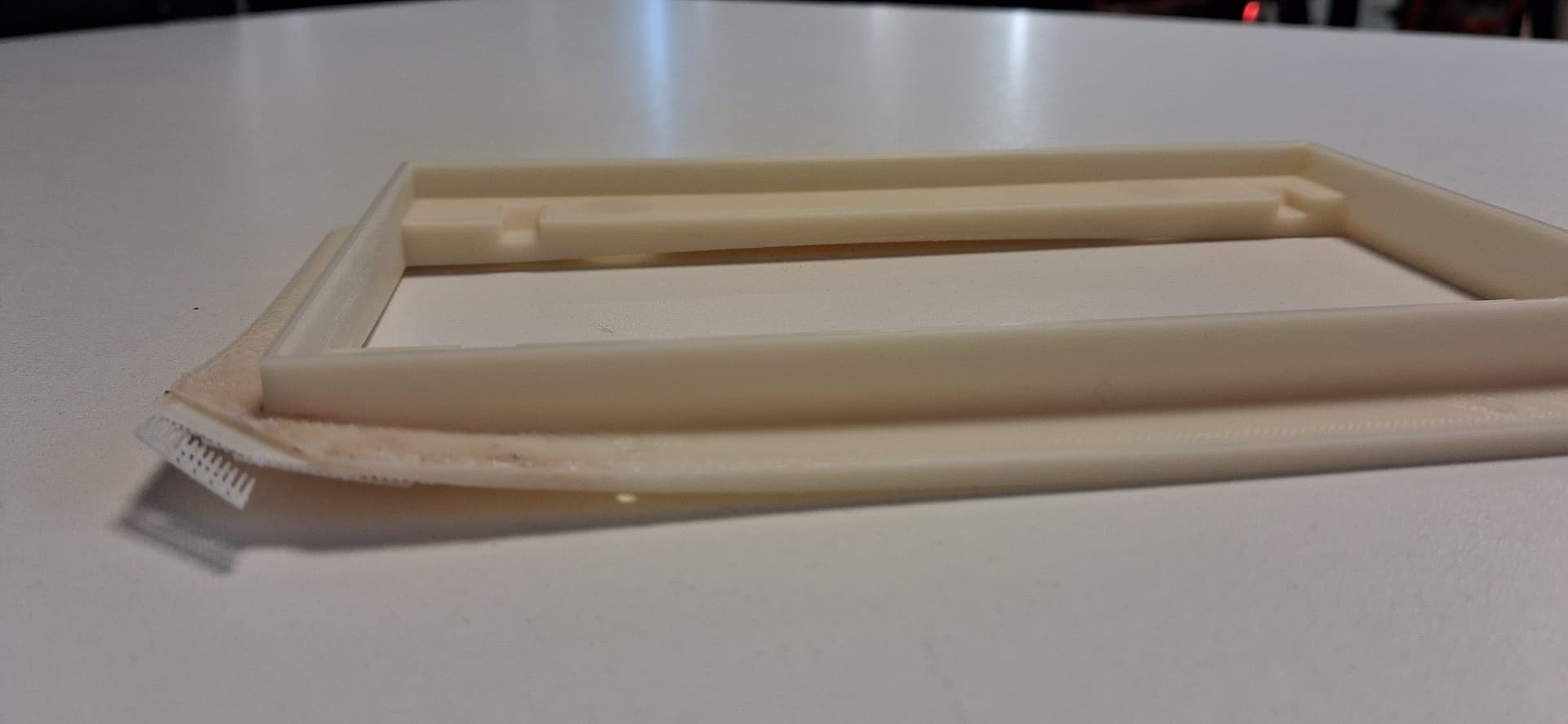

  • The first layer mostly looks fine
  • However, one corner of the print consistently lifts up (warping)
  • The rest of the print adheres well and looks good
  • The lifted corner causes deformation in the bottom layers

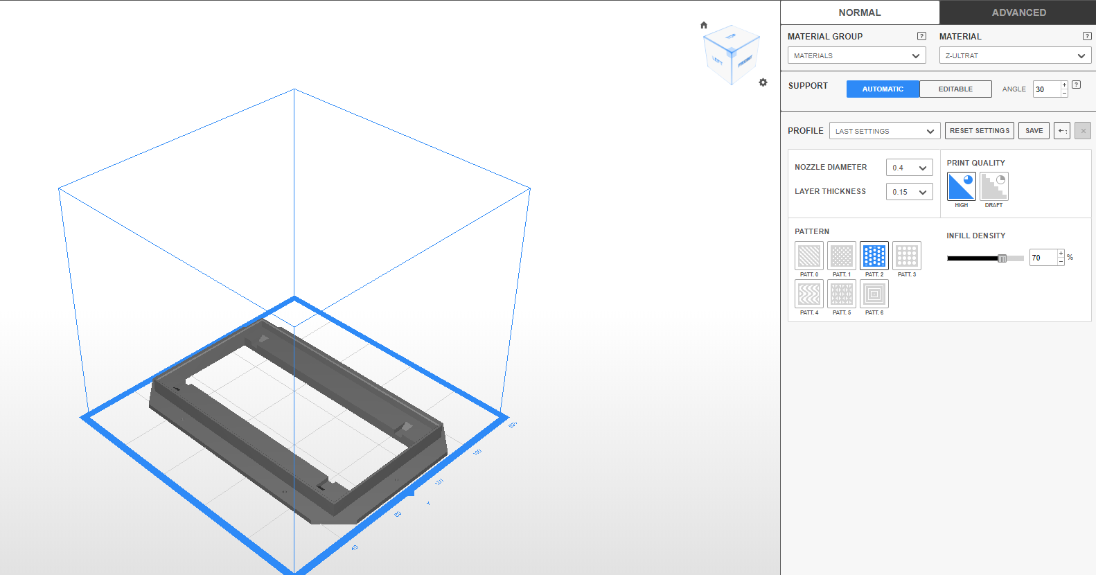

  • Printer: Zortrax M200 Plus
  • Material: Z-ULTRAT
  • Nozzle: 0.4 mm
  • Layer height: 0.15 mm
  • Infill: 70%
  • Support: Automatic (30°)

Observations:
  • The issue is always at (or near) the same corner of the build plate
  • The first layer in that area seems slightly less “squished”
  • The rest of the bed seems perfectly fine

Anyway warping happens when the temperature is too small, try adding enclosure or making temps a bit higher
Problem solved and the solution was simpel : the bed was not level after first calibration. Re-calibrated = result ok now.
Thanks!
