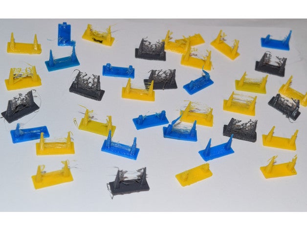

So after giving up printing PLA (even Zotrax’s own PLA-Pro), I’ve decided to try Ultrat, as it’s basically ABS. I’m running the latest Z-Suite and latest firmware, first print bonded itself to the raft, so I had to tweak the first layer gap. On the second print I’ve noticed stringing, which I’m guessing is coming from too high of a temperature as the entire model looks fairly “melted”. I’m using a brand new heater + temp probe and resistance is bang on 15ohms. All fans work properly.
Any ideas what might be causing this? Ambient temp in the room is 21*C.

Far from perfect as you can see. I’ve not tried any other materials, will try standard Zortrax ABS tomorrow. Hot end is brand new, only used for a few 10mm XYZ cubes, then taken out, cleaned to make sure no PLA is left, then cleaned with rigid.ink Floss (cleaning filament). All of the prints which have been problematic have been made with the new heater / thermal probe installed, so perhaps that’s the issue. I’ll try to go back to the original and do some test.
