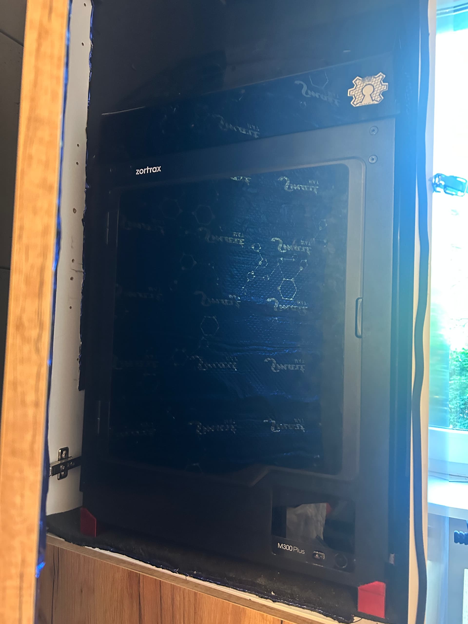

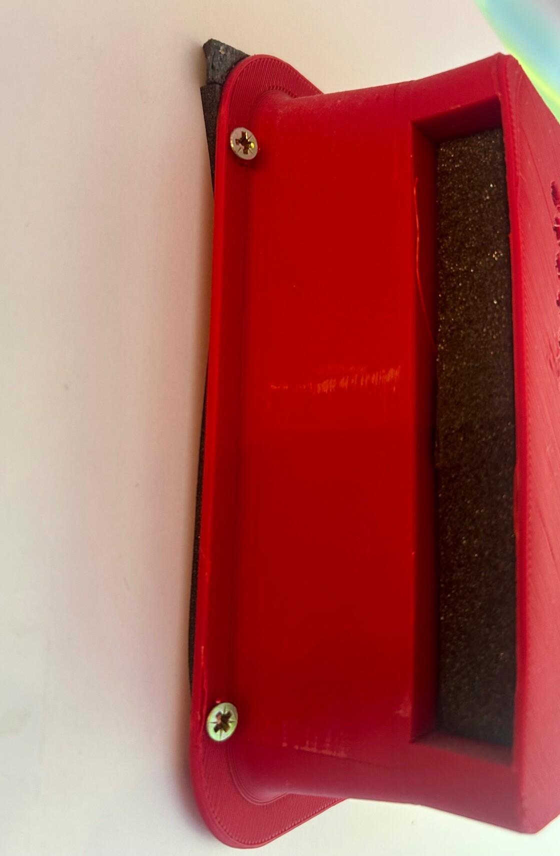

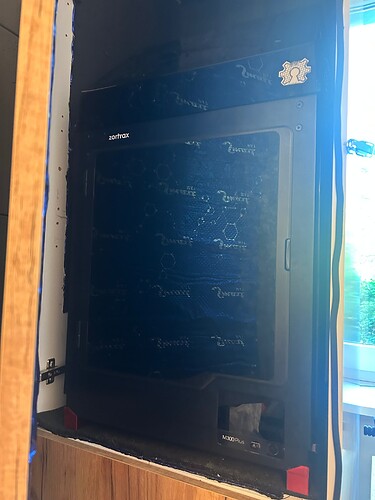

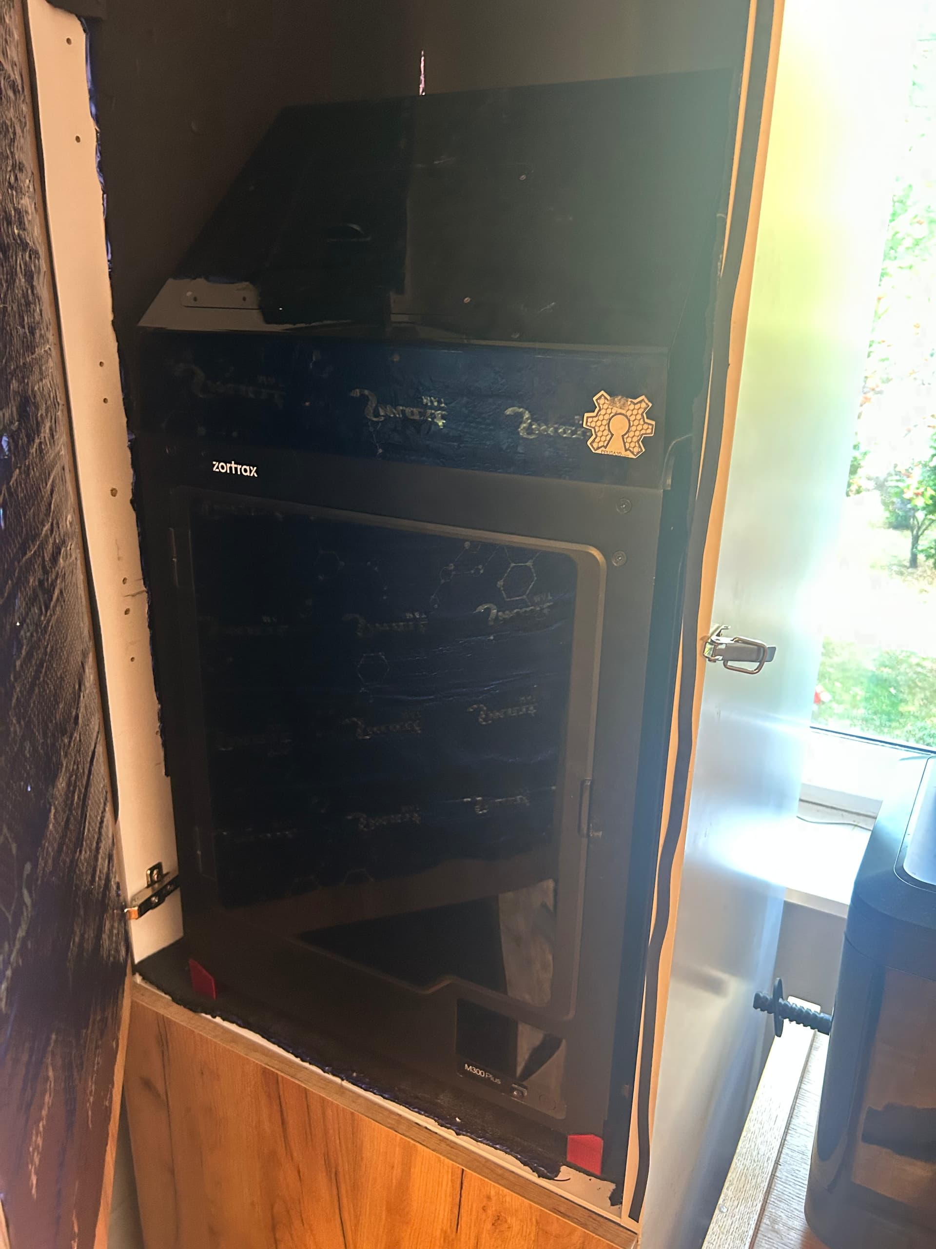

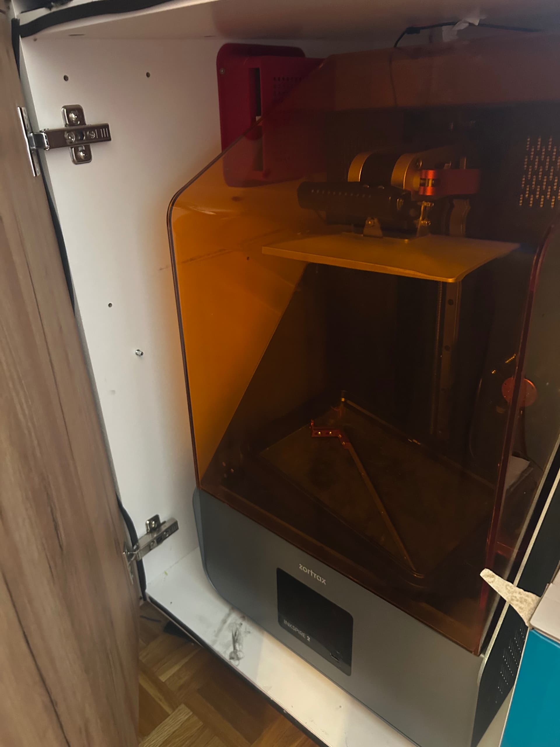

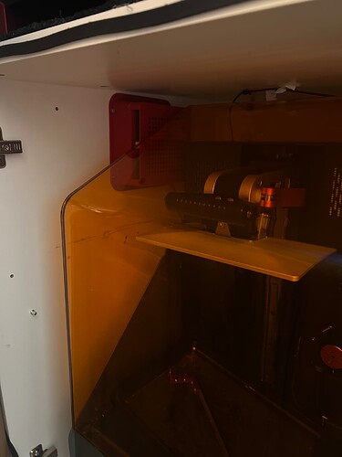

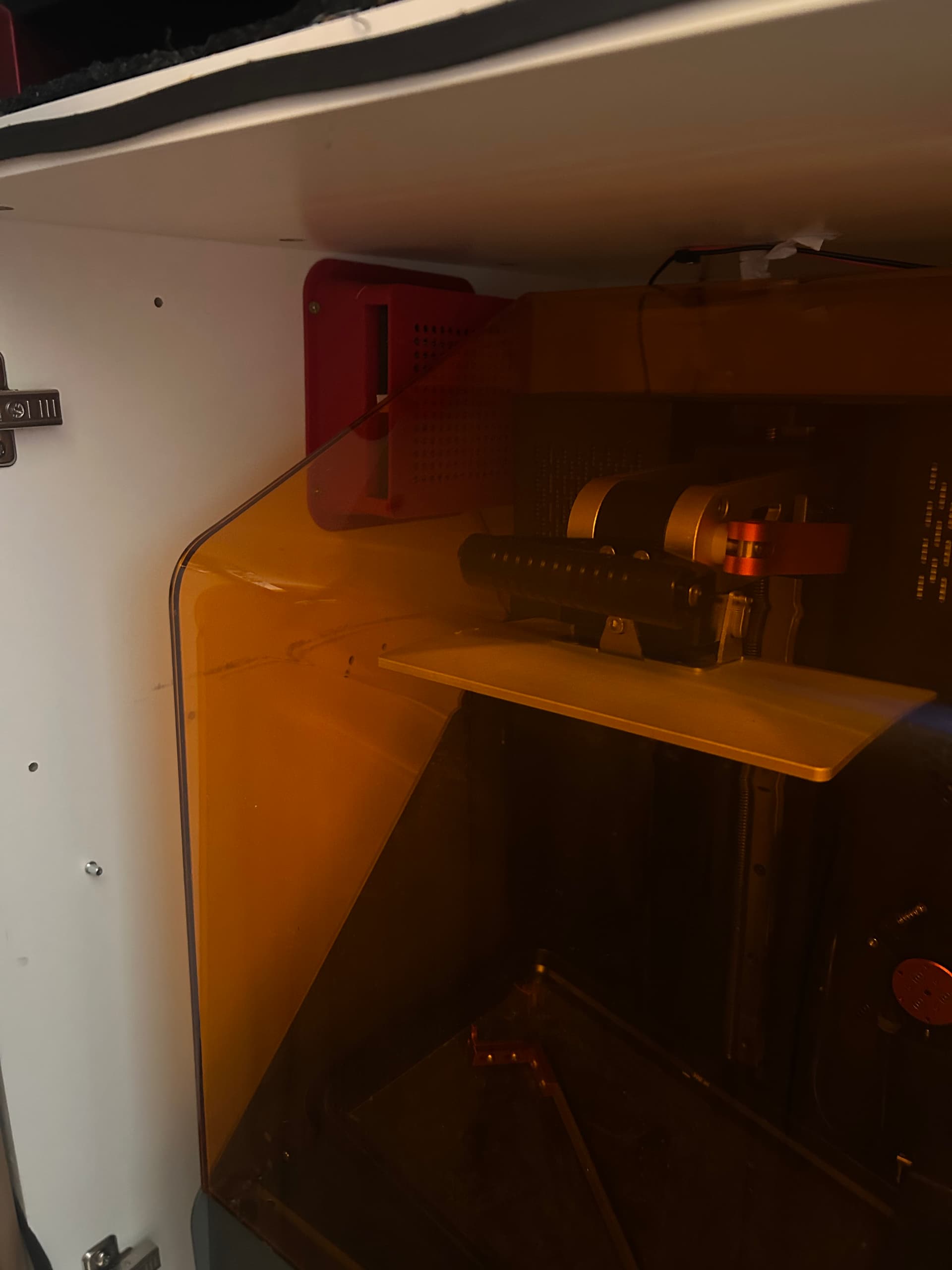

Hi! Thanks for your questions. Generally, most filaments from reputable manufacturers and trusted sources are safe for 3D printing. However, good ventilation is essential. A HEPA+carbon filter can remove up to 99% of harmful particles, but keep in mind that printers aren’t completely sealed, so trace amounts of emissions may still be released. I use a custom enclosure with a HEPA+carbon filtration system (the red components in my setup) and a soundproof seal. I also monitor VOC and TVOC levels with a sensor to ensure safe printing conditions. I don’t use a HEPA cover filter, as it wasn’t sufficient for my needs.

I’ve attached images of my printing enclosure for reference. From my research, the filters I use are effective. The Zortrax cover alone wasn’t enough for my setup. I also monitor all indoor parameters using a Tuya air sensor.
