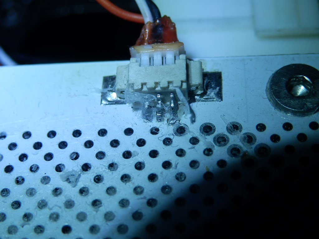

Check if there is any damage on the pins of the smaller platform connector or if they touch each other. That would explain the strange behaviour of your printer. You might have accidentally damaged the pins with spatula.
3029

You should turn the printer off immediately when it crashes.
At first look i didn't see a problem in this, but I spent a cutter in between the pins and voila!, the problem has solved!
Thank you very much, you save my life :D  :D   :D   :D   :D   :D
