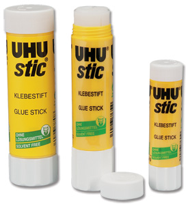

I use UHU Stic glue. You can buy it in stores with school supplies here.
I tried hairspray but it was ineffective.
