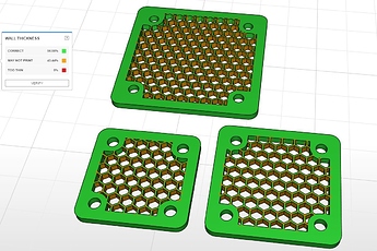

I cannot print a mesh/grill
I tried to print the Pi 4 case from here: Raspberry Pi 4B Case by mkellsy - Thingiverse
But the parts with the mesh/grill are not printed. I load the model in the software, all looks good, but when the software should preview/slice the model, the mesh/grill disappears and will not be printed. Is there a setting that I’m missing?

Hi Christian,
The Wall Thickness Analysis indicates that certain walls may not print.
Please, set the holes offset to -0.10 mm - the model should be printed fine then.
