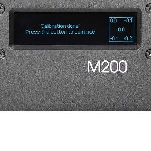

First of all, please complete the autocalibration process.

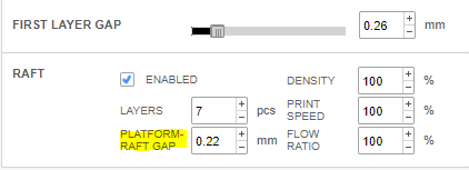

Secondly, if the abovementioned does not help, please increase the value of the platform-raft gap in Z-SUITE (you’ll find it in the advanced options).

The platform maintenance should be done every working 300 hours. However, if you are having problems with removing the prints from the platform - you may try increasing the platform-raft gap in Z-SUITE. It should be easier to remove the raft then.
Ok Karolina , thank you, but what is the name of the parameter in Z suite which allows to change this difference.
Thanks Karolina for your support. I will give a try tonight with another print. Willy86, select 'Advanced", then at the bottom, you have a zone of settings called “RAFT”, this is the last setting at the bottom of the window. With Z Ultrat I have 0,24mm. I will increase it to 0,50 (don’t know if it is enough. I will give you some feedback within 3 hours)
I applied platform-raft gap of about 0,50 mm instead of the standard 0,24 for the Z Ultrat and it worked perfectly. The raft has been removed very easily . I will keep doing this way for the future. Thanks everyone
Thank you for the update - I am glad that adjusting the parameter did the trick. But do not increase the gap too much - otherwise, the model may warp instead.
