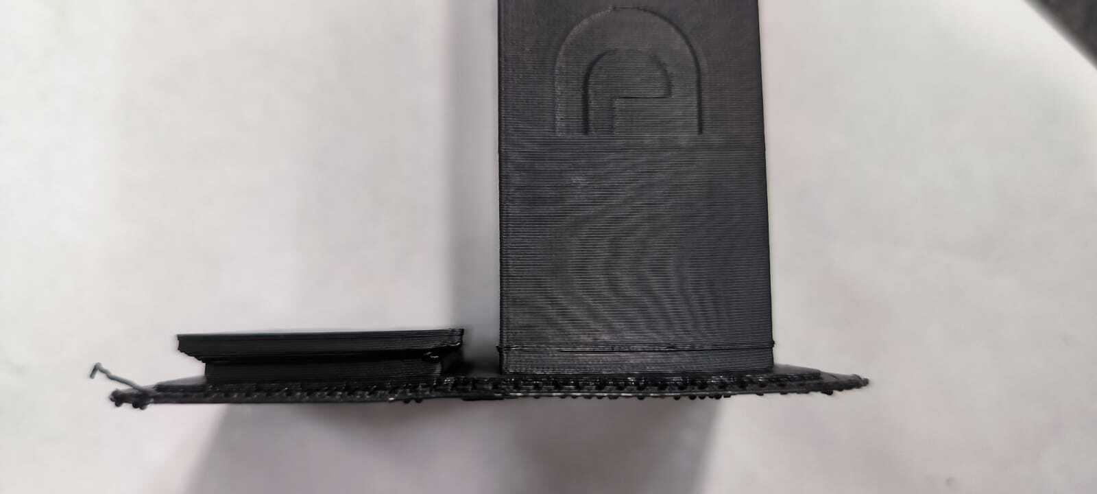

The printer has a problem what make like a elephant foot when geometry change, in the photo can see it (dont see the missing support in the other part). In the upper layer allways make the same too.
Any idea? Thx!!

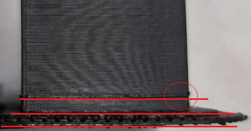

As the elephant’s foot is caused by the weight of the object pushing down on the first layer (which seems to be fine here) - in this case, it seems the model has warped - please compare the pictures below:
Over here you will find tips that help to counter warping. Most of all - install side covers and HEPA Cover, ensure that calibration results are fine and platform is not deformed, apply some plate adhesive, maintain stable ambient temperature (at least 22-24 Celsius degrees).
