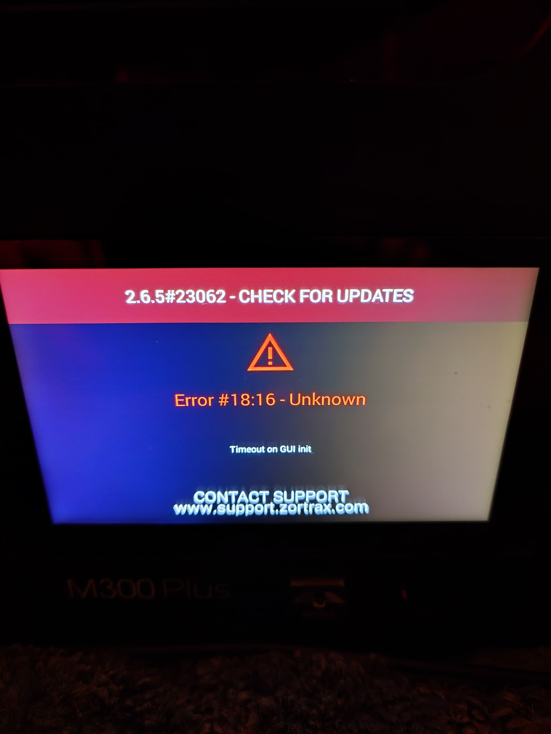

Error #18:16 - Unknown
i am getting a Error # 18:16 - Unknown
this is on my M300 Plus
any ideas?
Hi @jsferrell,
When exactly does the error occur? New firmware version (2.5.2) was released yesterday. Please, update the device and let us know whether the problem reoccurs.
It was happening right at the first of the program and it happened while running the print.
I purchased a new SD card and so far the problem has not come back. i am not sure if that was the fix?
time will tell.
I have exactly the same error message and no idea what it means. It happens a while into longer prints.
Hi @david3141,
Have you tried updating the firmware to 2.5.6? Will the same error occur then? Just in case - please, check the connections as indicated in the troubleshooting manual.
Hello Karolina,
I updated to 2.5.6 and the error persisted. It is possible to print quite long prints, but sometimes this error just pops up.
Hi David,
thank you for the update. Please, contact us via support form so our specialists can look into the matter. Also, please ensure the printer is connected via Internet so when the error occurs - we should then receive the logs which will help us find a root of the problem.

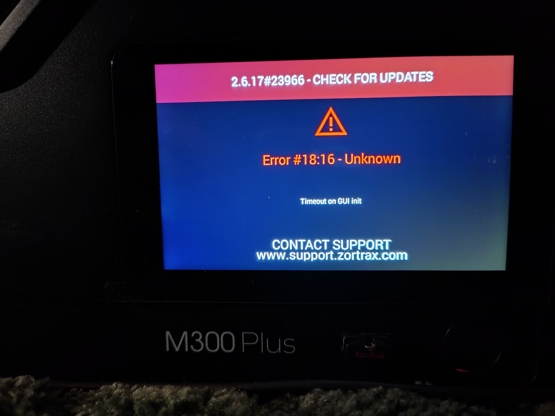

Hi, I’m getting this error with the latest version of the firmware
please help me :frowning:
please check the PSU connection and then contact us via support form. You may also check the heatbed cable plug for any burn marks (please take some pictures).
