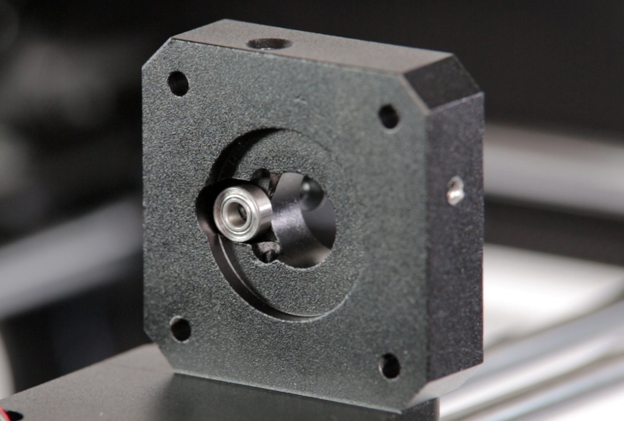

Installed brand new hot end and nozzle.
At this point I noticed the motor on one machine was skipping/stuttering on every revolution, so I disassembled and cleaned debris from the gears. Made sure all parts were correctly put back together. That fixed the stutter, but the original problem persists.
Fairly confident this is not a blockage in the hot end because they are brand new zortrax components as well as the fact that I can apply pressure and get more material. Each time, the print will start but inevitably stop pushing material after a few minutes. It just seems like the motor cant grab hold of the filament. I am using proper filament for each machine.
