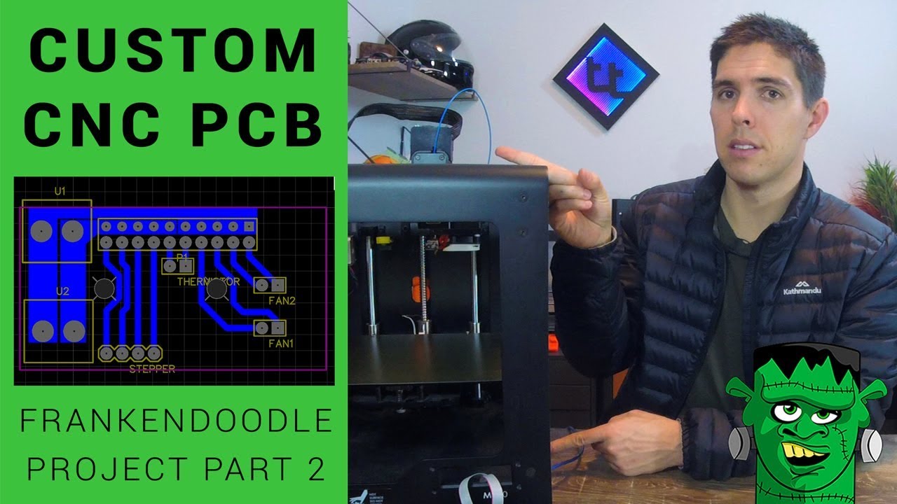

A new motherboard would almost be a drop-in replacement, but there’s an annoying aspect of the breakout board that connects to the ribbon cable in the extruder assembly, detailed here:
It has some components that get in the way of our connection to the temperature probe for the hotend, so it requires 2 custom breakout boards to use the original ribbon cable. In the video he CNCs his own circuit board, but there are PCB manufacturers that do small scale hobbyist stuff like this for reasonably affordable prices. Another way to hook it up would be to just yeet the ribbon cable and use a bundle of wires terminated with JST connectors, which is what others have done over on the Duet3D forums:
I’m not sure what kind of temp probe the M300 uses, I haven’t checked it out. It is likely not hard to substitute them with your own, while keeping the original extruder assembly. The Duet users have dug deeper than I have.
Other than that, most of the components in the M300 would be plug and play. The motors are normal 1.8 degree steppers, the Z axis homes at max, X and Y on min, and the heated bed is just a fat resistor.
