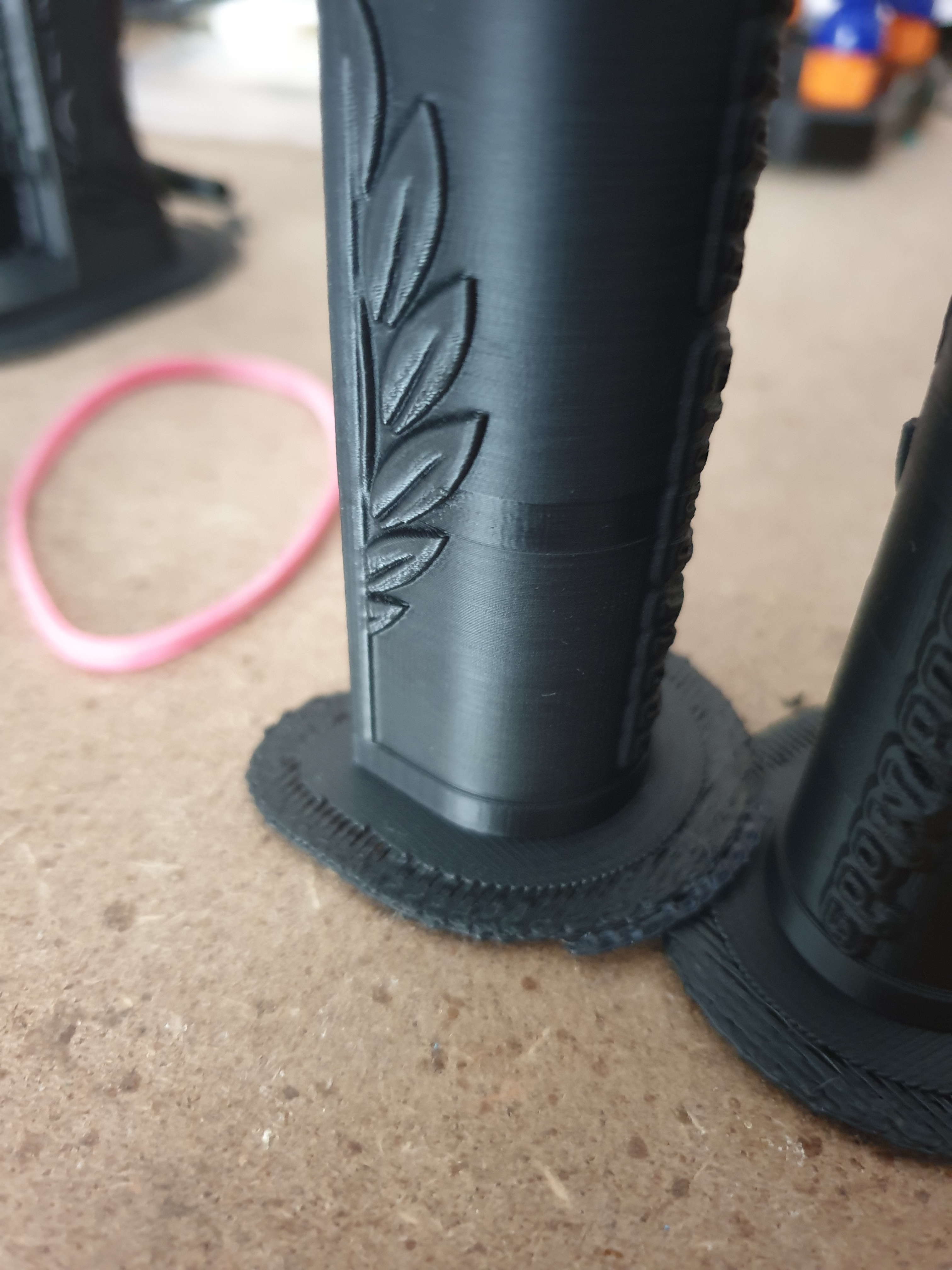

Hi!
Is anyone having any idea about these horizontal lines and the lack of filament right after the seam?
Hi!
I’ve been getting a similar result on models that were printing fine before. I think it’s a software issue, gonna try and downgrade the suite when I get a chance.
Hey there! Which Z-SUITE version do you use?
z-suite Version 2.8.3.0
Thank you for the information. Could you send us your files as well? We’ll print it and pass the results to our specialists.

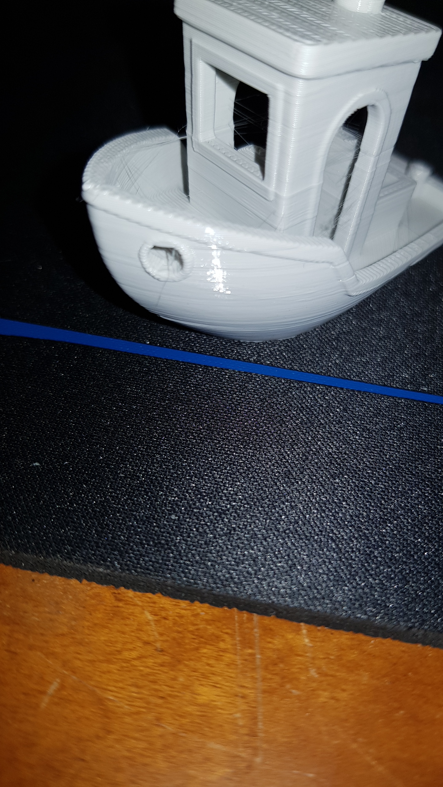

Sorry I cant send u the file due to copy write but I have done som tests on benchy boat and I have tried many different things and setting even changed the extruder motor but the problem with less extrution after the seam is always there.
Heres the benchy file 3DBenchy.zcode (2.5 MB)
Could u send me a .zcode file with 3d benchy? so I could print one in my printer?

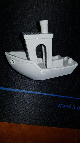

see pic below for my settings. Many thanks in advance!!!
and some pic of my benchy
That’s fine. I will print your benchy in that case.

Heres the result. the same as my benchy. theres under extrution just after the seam start. is theres a setting to adjust it? so before eache line start the printer push out some extra filament?
Have you tried to print my benchy?
Thank you for the pictures.
I have printed it with ABS and there is slight shift near the seam.

Just to rule out the possible of mechanical issues I installed the first version of Z-suite 2 on a clean computer and printet the benchy boat with significant better results so I tried the latest version of Z-suite on that computer and it turned out a very god print too. so I unistalled Z-suite on my computer and clean the whole computer from everything from zortrax and installed the latest version from zortrax website insted of updating an old version of Z-suite and woila the lines are more or less gone.
LINES ARE BACK
It looks like version 2.7.0 is the best version for my printer, the lines right after layer start is back on the latest version. Does Zsuite create different zcode depending on pc setup?
