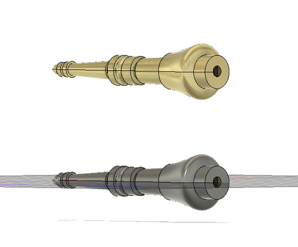

I used fusion360 to create the following When I tried to 3d print it using the Z-suite, the software restored the data on its own and I am having trouble. What should I do?

you can import the model without repairing (Model → Import without repairing), however, please remember it may not be printed correctly (if walls are too thin - you can do the wall thickness analysis to check this).
To prevent Z-SUITE from automatically repairing your 3D printer STL files upon import, you can use the “Import without repairing” option. Here’s how:
