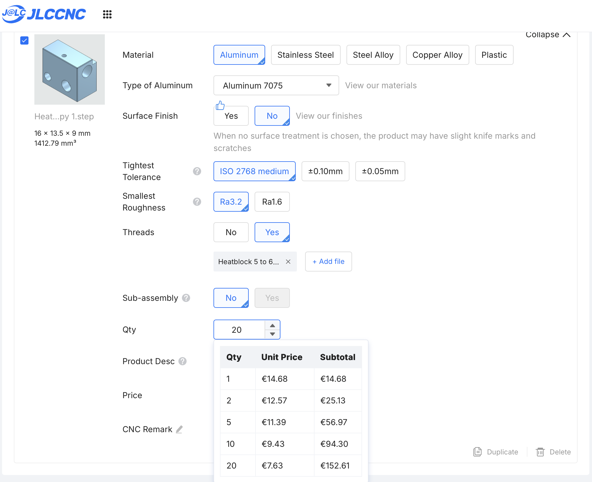

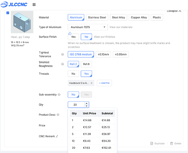

I had the same issue so I created a 3d model and CAD drawing of the heat block to send to any CNC manufacturer like JLCCNC to be made which I open sourced here:
The 4mm cardridge heater and 3mm Temp Sensor can be replaceable with Ultimaker types and some (de)soldering.
I am even thinking on creating a new heat break with a M6 screw so the generic 13.5x20.x9mm E3D V5 Heatsinks can be used, but that will take some more effort. Would anyone be interested in this?
My first attempt will be the left heat block to test fit:

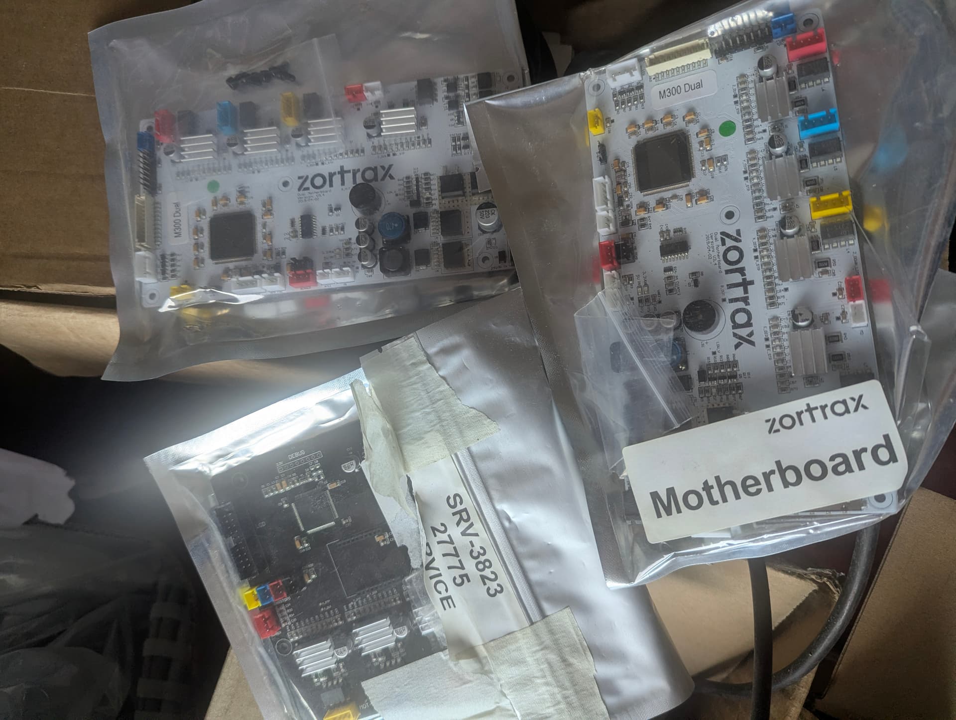

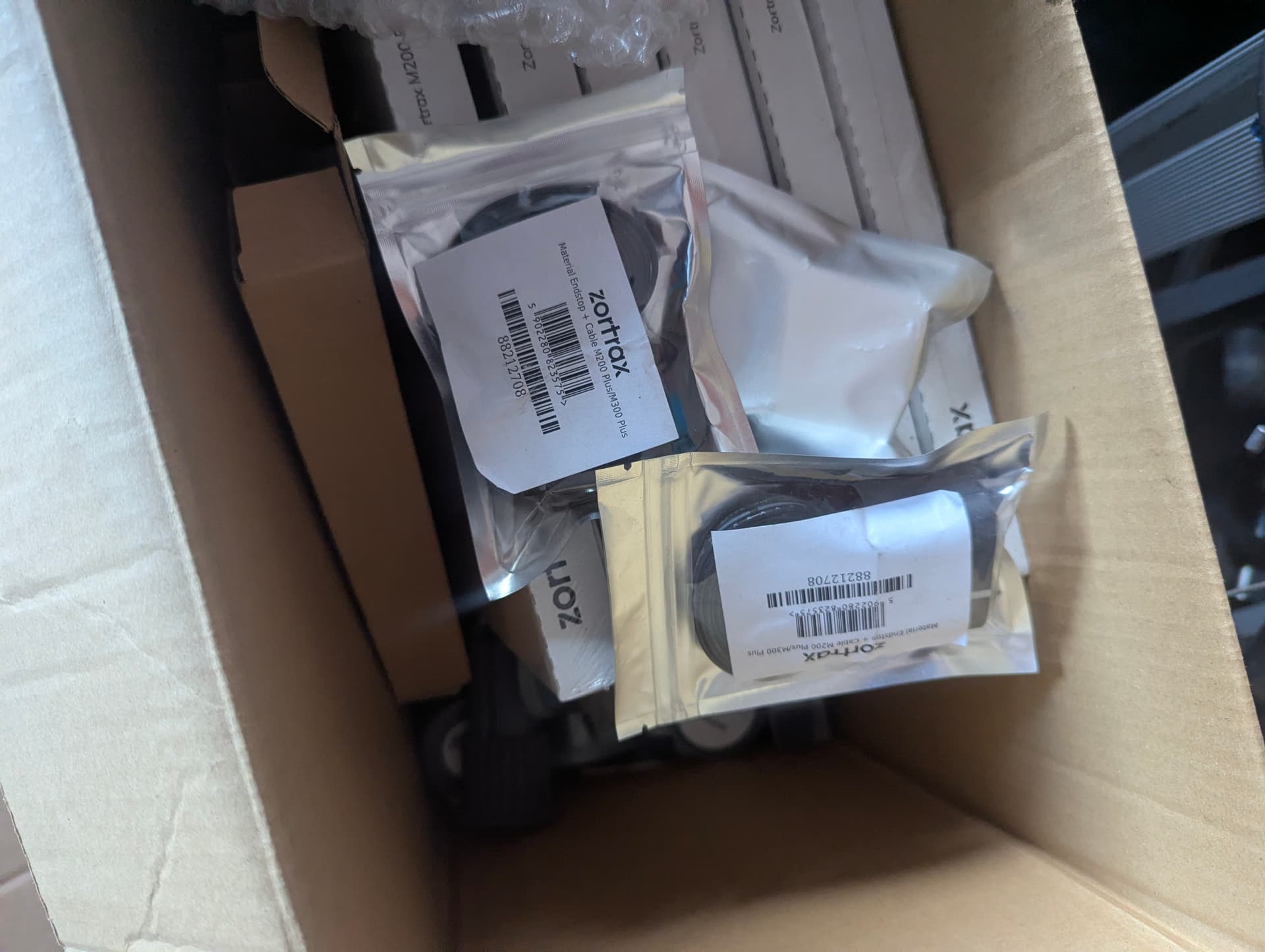

if anyone is interested I have alot of parts I got from a stock liquidation. mostly for m200,m200 plus and m300 dual. modules, power supplies. main boards ,motherboards , extruder cables , complete looks, heaters and temp probes , heat beds, perforated plates etc.
hit me up with what you need I may have
