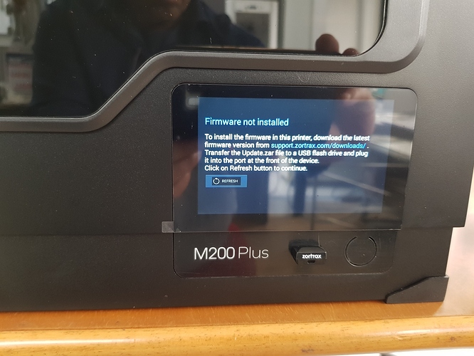

I bought M200 plus yesterday and I have the same problem … Impossible to install Firmware 1.2.0 on my brand new M200 Plus. I red what mathieu wrote but it doesn’t work for me. When I start M200 this is page I can see ( photo) but I can’t do anything else in this page … How can I set the wifi bypassing this page? Thanks
Hey there!
As there is no firmware installed on the printer, it’s not possible to pass this page to the printer menu.
Try downloading 1.1.1 firmware version, upload it to the USB stick and try to install it on the printer. You should be able to later update the firmware to newer version.
Please, let me know if it helps.
