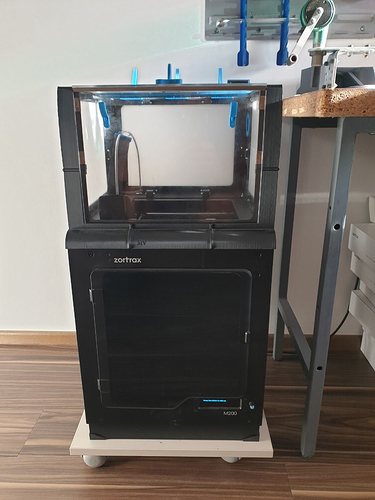

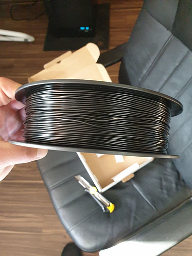

I am printing with Zabs almost for a year, but not so large objects, i have an enclousure on my m200 and stable temperature around 30 degres. Today i get Z ultrat but am very disapinted of it quality.

If you’re worried about quality or notice any tangles on the spool, give us a shout via support form.
