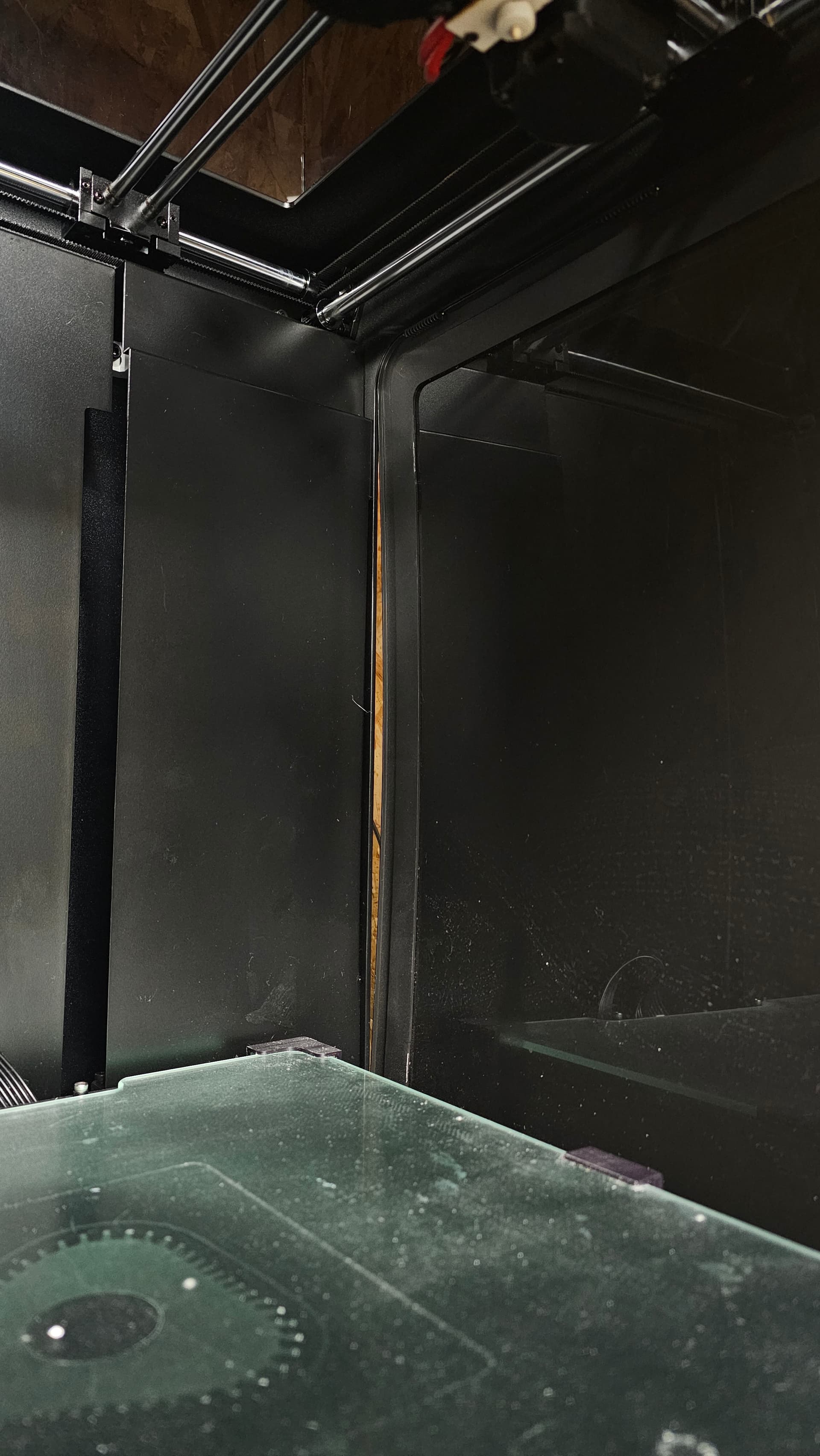

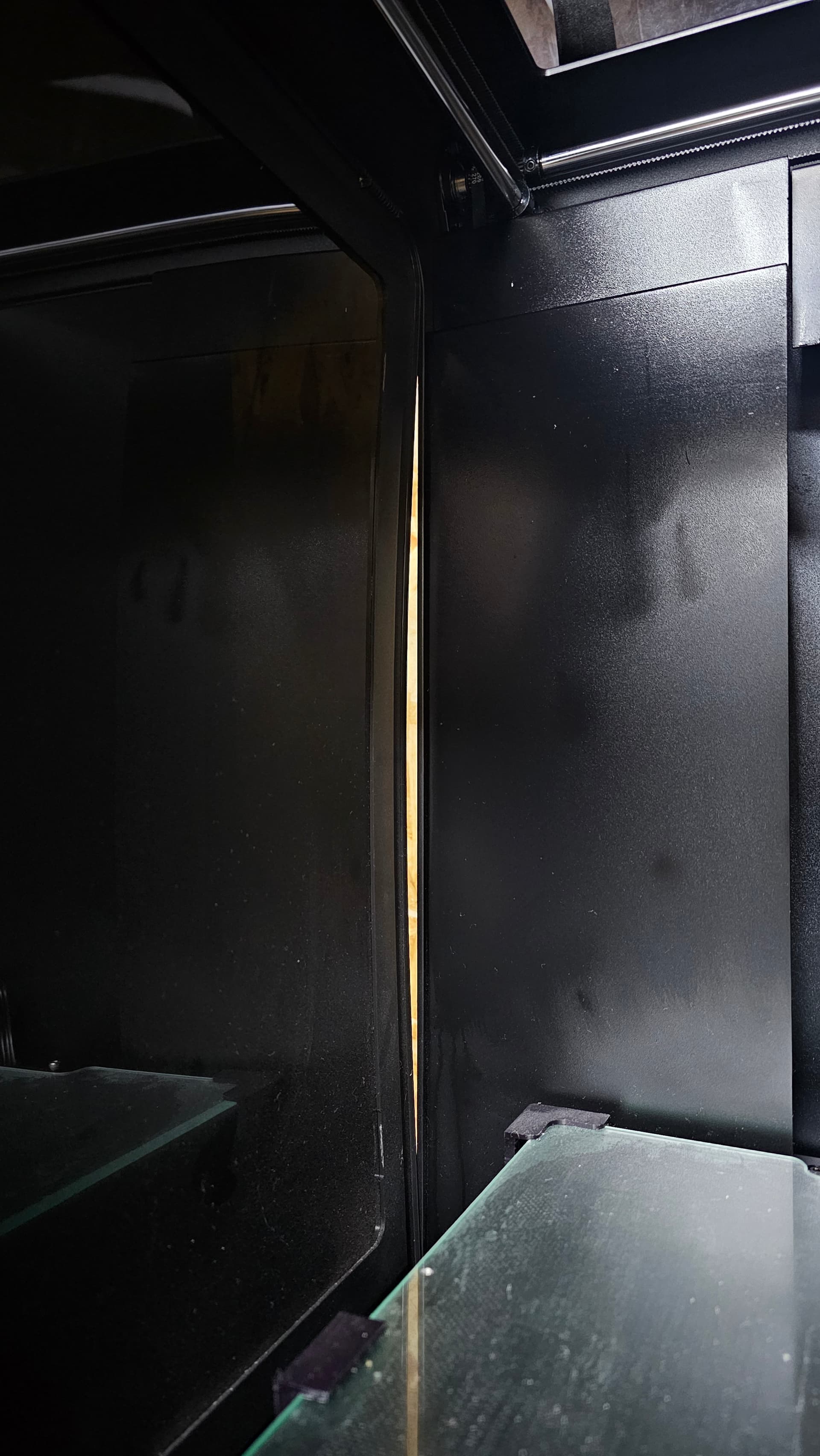

My panels are deformed from the factory. How can I make them straight? After I installed them there are gaps between the metal chasis and the plastic panels…

Do you have the latches properly secured at the top and bottom of the panel? Are there any filament residues or other obstructions in their place? It’s strange because I haven’t encountered this issue before. These panels fit very well, and in my printer, even after 5,000 hours, they still work without any problems.
All clean, no residue and the ears are in place. The problem is that they are curved even if they are not installed on the chassis. They are like this : ( )
Will the heat treatment fix my issue? Meaby with a heat gun?
You know, you can try, but it’s very strange. I print a lot at temperatures over 105°C on the bed, and I don’t have this issue. Try heating them, but remember that it might warp them even more. I would try swapping the sides; maybe that will help.
The m200 plus ones that I have are perfect… so idk

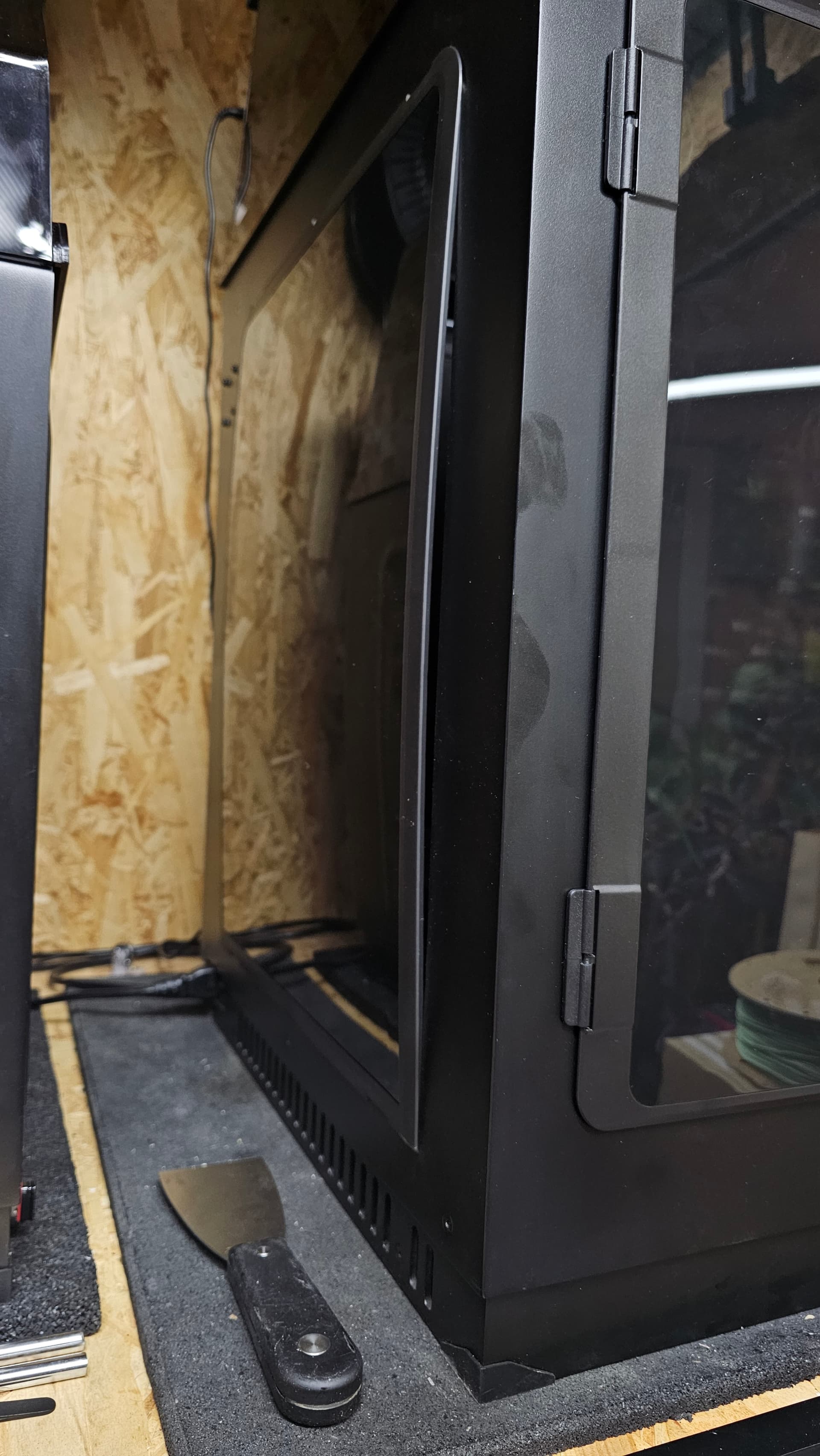

Ok so I managed to make them straight with a heat gun. The problem și the metal chassis. The hole is too small… now what? :))

perfect. I just got the panels from Atome3D and when they are installed, they stay the same… a little curved. Dissapointed
