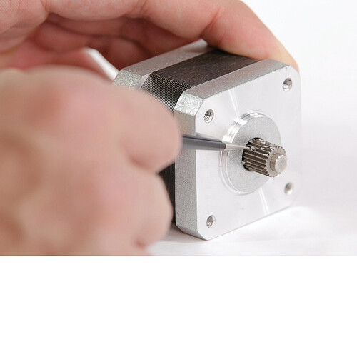

  • Disassembled the extruder assembly and cleaned the feeding gear

Please uninstall the extruder motor again and assemble it another time trying to get the motor’s sprocket closer to the extruder bearing. Probably the string of material is not pressed enough by the sprocket against the bearing and the materials is not pushed forward.

I had another look at the motor and realised the extruder bearing was infact broken.
I replaced the bearing and extrusion is alot more consistant now but unfortunately another issue has arrisen. Since replacing the bearing the motor has begun to occasionally skip.
