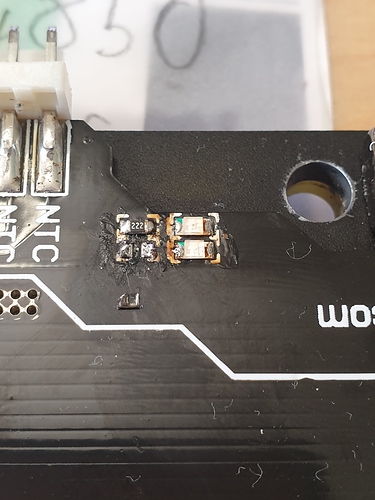

My heated bed has shat itself and blown a SMD resistor. Im a student so I’m not too keen to replace the bed and would rather fix it with another cheap resistor. However, since its blown or disintegrated, I am now unable to read the usually legible white resistance indicator printed on the surface.

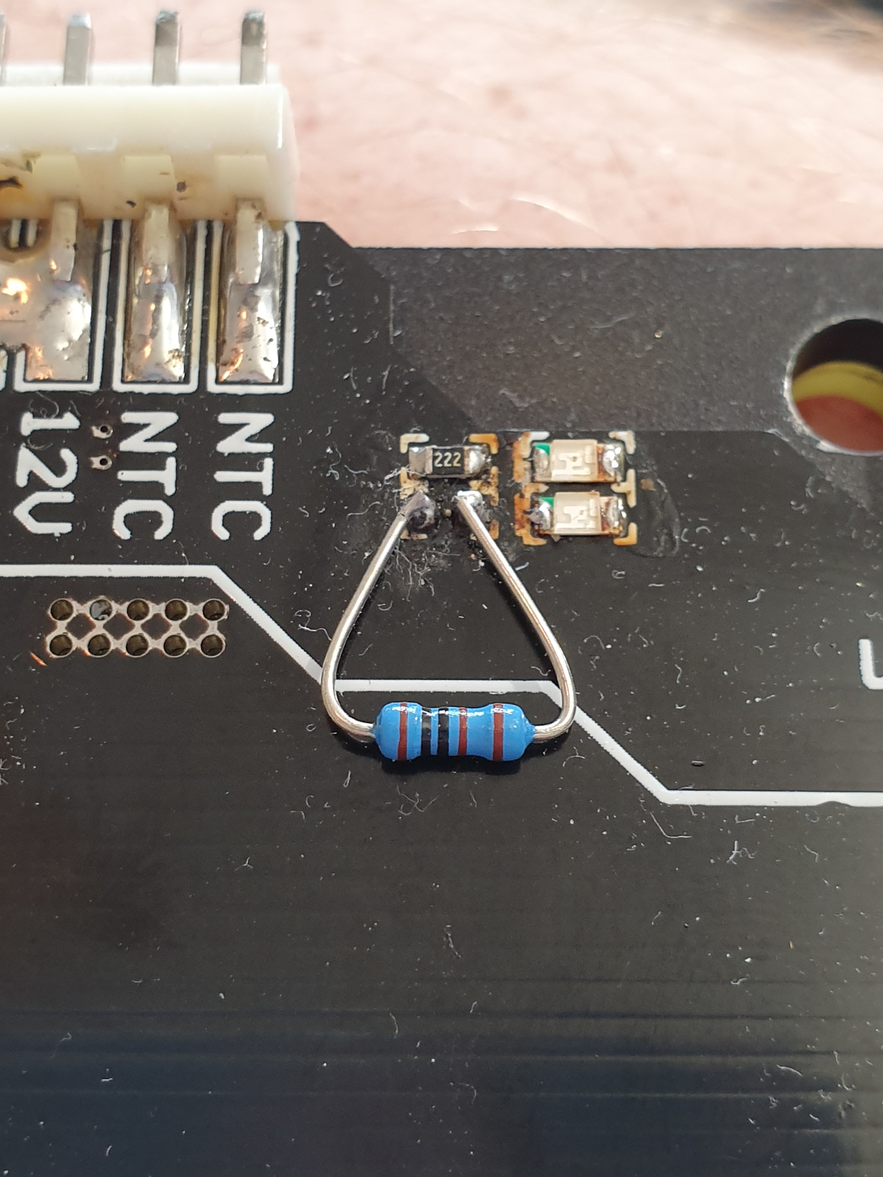

Thanks Marta! You’re an absolute champion.
Great idea. Ill keep all that in mind when I swap it out :ok_hand:
It worked! Ignore my terrible soldering skills please :neutral_face:
Autocalibrating and printing just fine :ok_hand:
Thanks again Marta!
