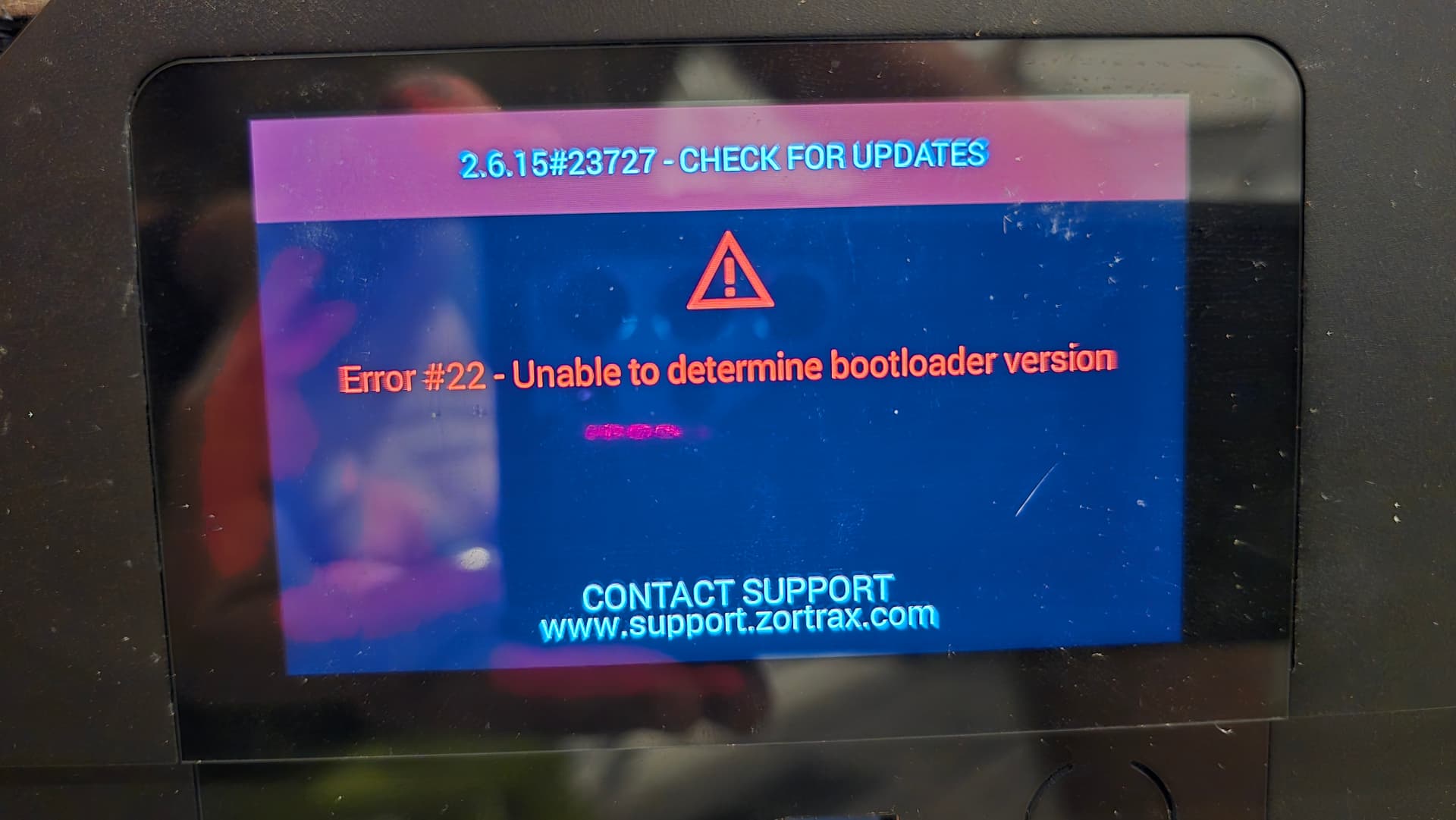

Them another time, when i took the usb out, i got the attached message.
Thanks for your message. Provide more documentation, such as photos or videos, and then remote assistance might be possible
