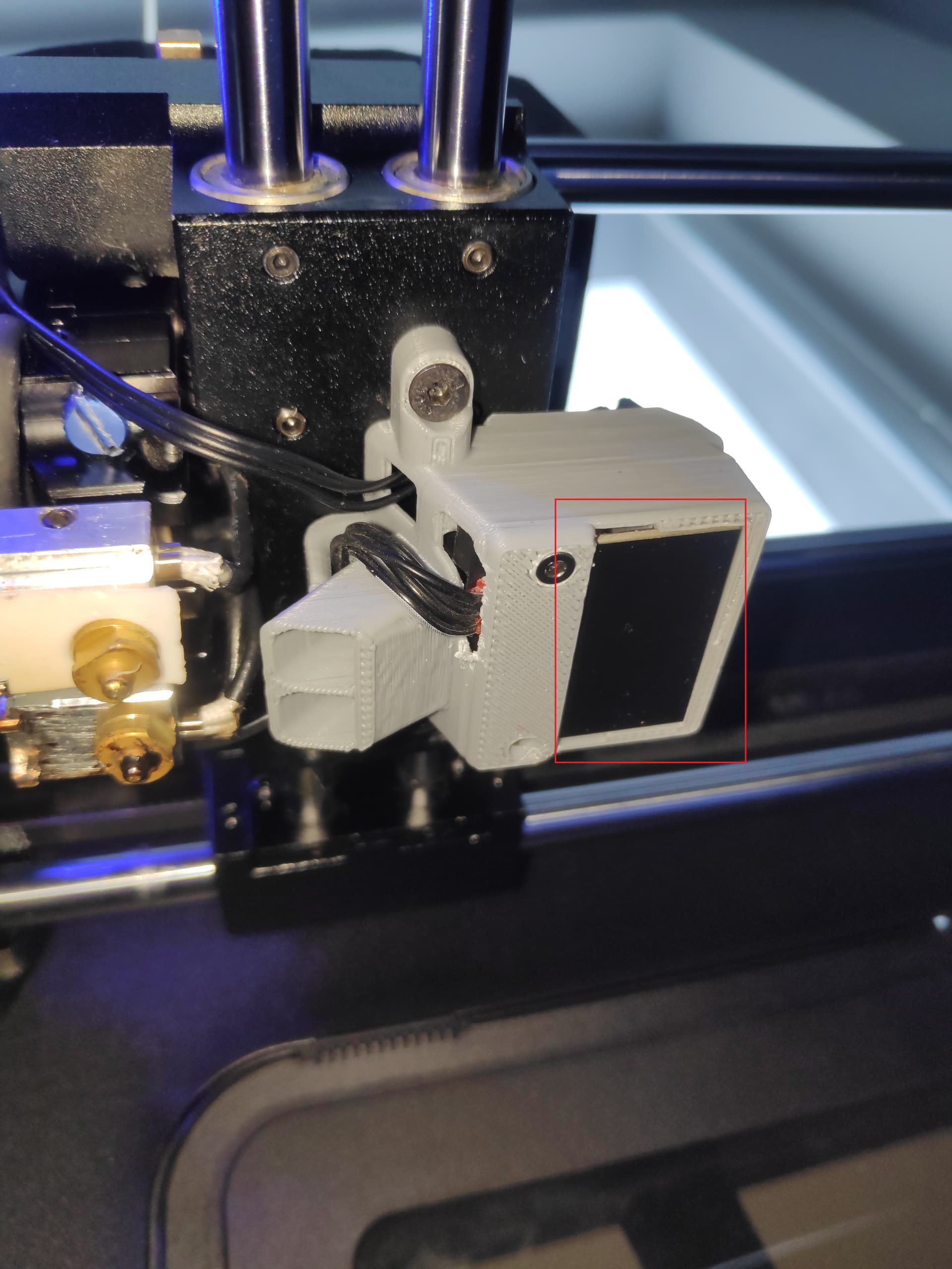

Hello Andy,
as for the first issue - I believe you are referring to the automatic platform calibration that involves using the capacitive sensor, right? When exactly does the error occur, do you have any picture/video?
The cap sensor is the sensor which allows the printer to perform contactless platform calibration:
Most of all - what firmware version is installed? If it is not up to date - we strongly recommend updating to 2.6.6 first.
