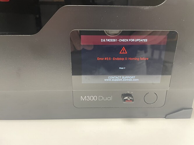

Firmware update were parallel with our maintenance period (after 300h), so we clean, lubricate, check and run calibration functions. In result we have two problems:
  1. Axes verification test after 4-5 min of movement the extruder stops in corner where both endstop switch (X and Y) are placed then message error apears #5:5.
  2. We run the Hotend switch calibration procedure, in the second step of process where we need to positione the extruder close to the left bumper the extruder does not want tu start, strange nois are became from back of the printer like slipping belt on the teeth wheel. error message apears #6:5
    We did the basic maitenance steps dedicated for every 300h of printing. Currently we have printed 336h

The error occurs when the extruder goes to the bottom left corner of the device whenever we try to set off the X/Y axes check procedure and sometimes when the extruder goes to the same corner upon heating for material loading. It usually hits the bottom case edge a few times and spits out an error, mostly in Y axis, sometimes in X axis.
We’ve undergone full axes maintenance procedure, changed lubrication and the extruder moves way smoother than before but optical sensors fail in said examples nonetheless.

We’ve been having the same issues even after axis maintenance. Once finished. we perform an axis check that causes the error below. The end stop doesn’t seem to work and before showing the error the motor tries to push the extruder 3 times and then the error pops up.
Is there any update on this matter? We’ve changed XY end-stops just in case these were faulty and causing the problem however it seems not…
The error code showing is #5.5

after doing axes maintenance, extruder is moving fine but when i try to do axes check.
it stops after few minutes and comes up with the error message that " axes check failed and need to carry out endstop x maintenance "
