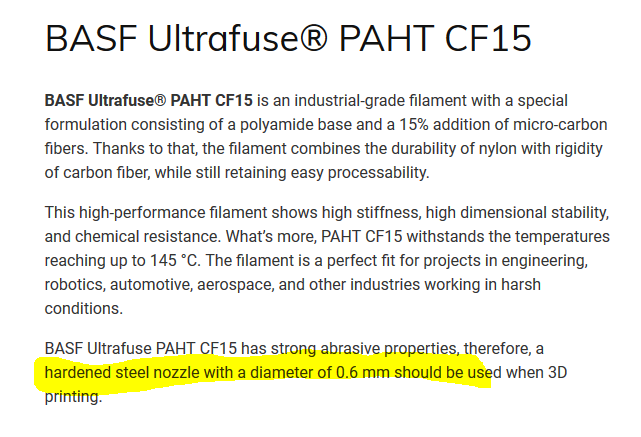

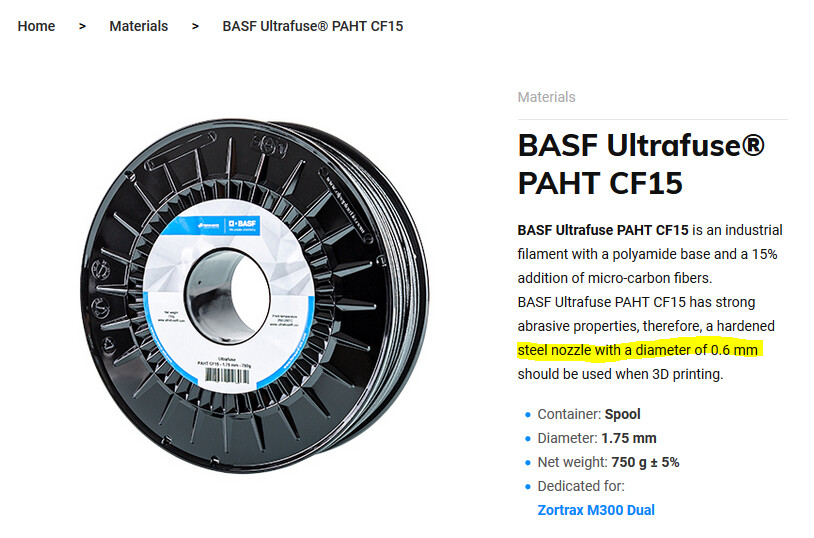

we have not tested this material so we cannot provide any information. Still, please note that we have introduced BASF Ultrafuse® materials for the M300 Dual - PP GF30 reinforced with a 30% addition of glass fiber, whereas PAHT CF15 - a 15% addition of micro-carbon fibers. Not to mention Zortrax Full Metal Package enabling 3D printing models made of two most commonly used types of steel: 316L surgical-grade stainless steel and 17-4 PH hardened steel.
As you can see - Zortrax devices are capable of printing industrial-grade filaments. Our specialists are constantly working on providing new materials and dedicated printing profiles. However, if you want to test any external material - feel free to tweak one of the provided external printing profiles, please just note that a steel nozzle or a separate hotend module might be required.

the standard nozzle for the M300 Dual is brass, however, filaments with strong abrasive properties require the steel one. Such information is listed both in the online store as well as on our website:

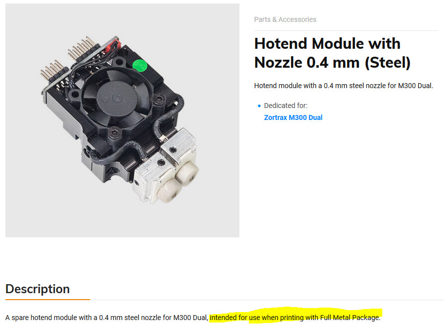

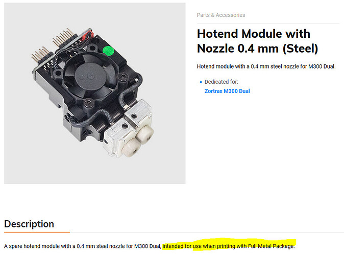

The hotend modules are actually the same, so you can change the nozzles only. However, if you were interested in printing BASF Ultrafuse 316L (surgical-grade stainless steel) or 17-4 PH (hardened steel) - is it recommended to purchase full Zortrax Full Metal Package which already incudes the module with 0.4 mm steel nozzles. Still, such information is also available in the store:
