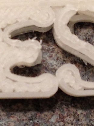

I too have noticed that on a thin walled part it won’t do (full) fill. I hope they get that fixed. If the space is larger than .4mm it should be able to fill it in.

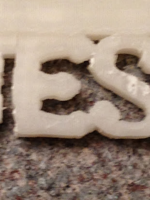

I have had the same issues. I thought I would try something different and change the position of the object in the Zsuite. Heres some pics of laying down and standing up. Now the standing up one printed way better but the horror of trying to peel off the support was grrrrrr! lol Just gotta remember we are in Zortrax infancy.
Just a few more tweaks and the addition of polycarbonate profile and I may be able to start mass printing! woohoo! lol
Cheers hope this helps some.
