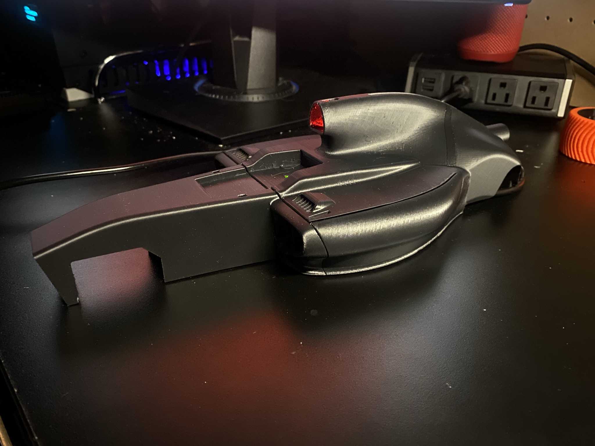

So far so good! Prints straight off the M200 bed:
Until…
Looks like I need to do a little axis maintenance. Machine has around 1600 hours on it… wonder if any parts in the xy assembly need to be replaced. Will plan to follow standard trouble shooting procedures.
This design is and is the OpenRC F1 project is by Daniel Noree. It can be found on thingiverse here. There have been multiple updates for parts across multiple sites over the years so I had to spend a few hours organizing all the versions to get the latest one I like best. Daniel’s site lists out the electronics to make it an fully built out RC car. Another great resource for RC builds is RC Printer.
If you do decide to build, consider contributing to Daniel’s Patreon here. He put a ton of work in!
