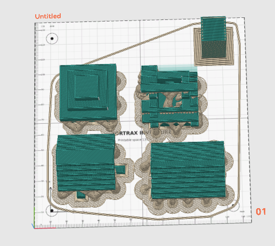

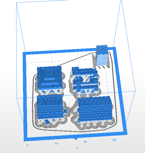

If anyone is interested in integrating ORCA slicer with Zortrax Inventure, here is the beginning of my project GitHub - MarcinKowalik-AGH/Zortrax-Inventure-OrcaSlicer-integration · GitHub
The converter now correctly generates zcode, which can be opened in z-suite and is separated by marker. Additionally, the filament and print speed parameters used by the converter and implemented by the presets for Orca have been added.
