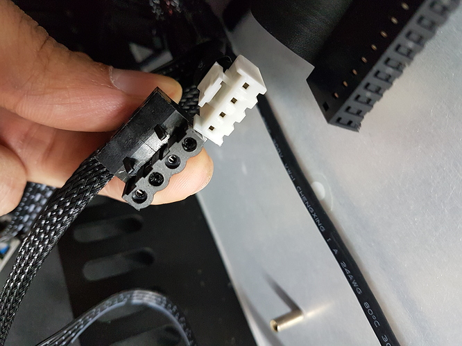

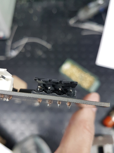

karolina i have found the problem. Connector power supply probably sottodimension… I am a technician and I have solved but I think you are interested, I attach the photos
The connector looks melted around pins and plug? If melted, I’d check for a short.
That’s right, it melted from bad pin contact, I fixed it by replacing it with a more secure screw connector.
