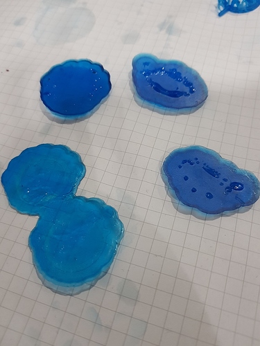

I tried to print rings and f.e. last time i put 3 exactly the same rings and only one was printed ( in middle of platform).

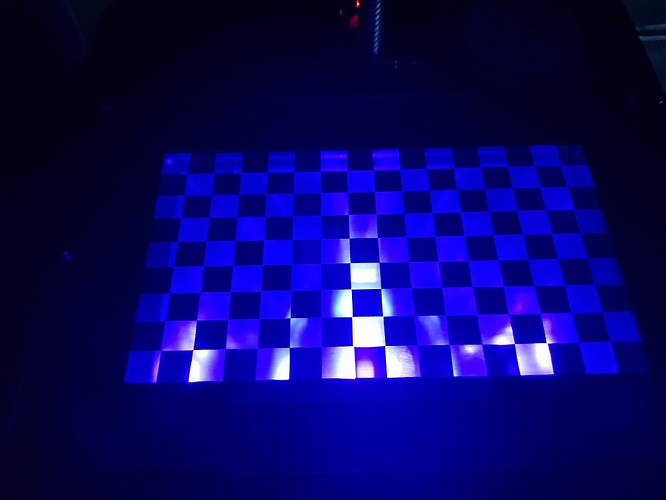

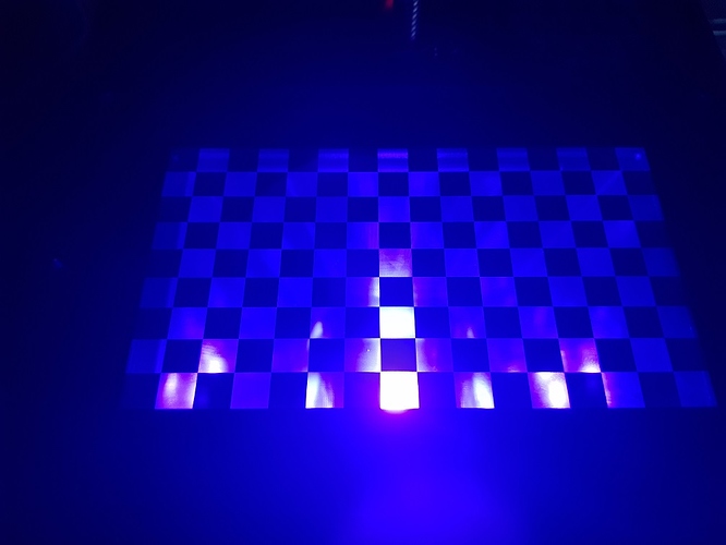

Do you have any pictures of the results you got? Could you also run the lamp test (Menu -> Tools)? Please, check all the patterns.

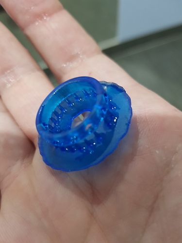

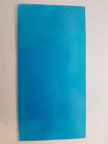

Below you can find pictures. Looks like part always fell down after printed raft.
I tried everything. I don’t have any idea what is wrong is totally hazardous. Additionally today I cleaned eveyrthing and run one more time lamp test after platform calibration, and I had after finished test this raft on platform but without any signs.
