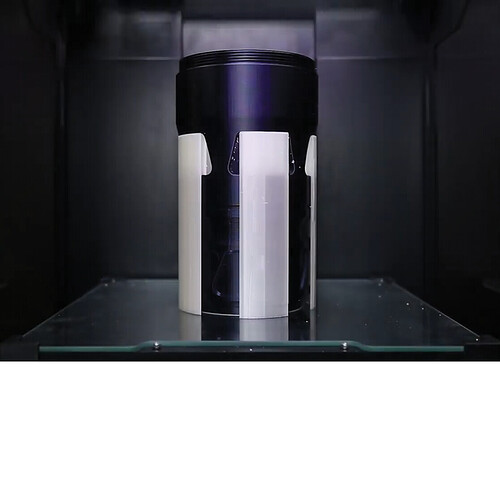

Hello Frederic,
Are you using the glass plate for printing without raft? It is recommended to use it, or the model might be of poor quality when taken off the bed.
Did you try using glue on the plate?
Below attaching the guide:
