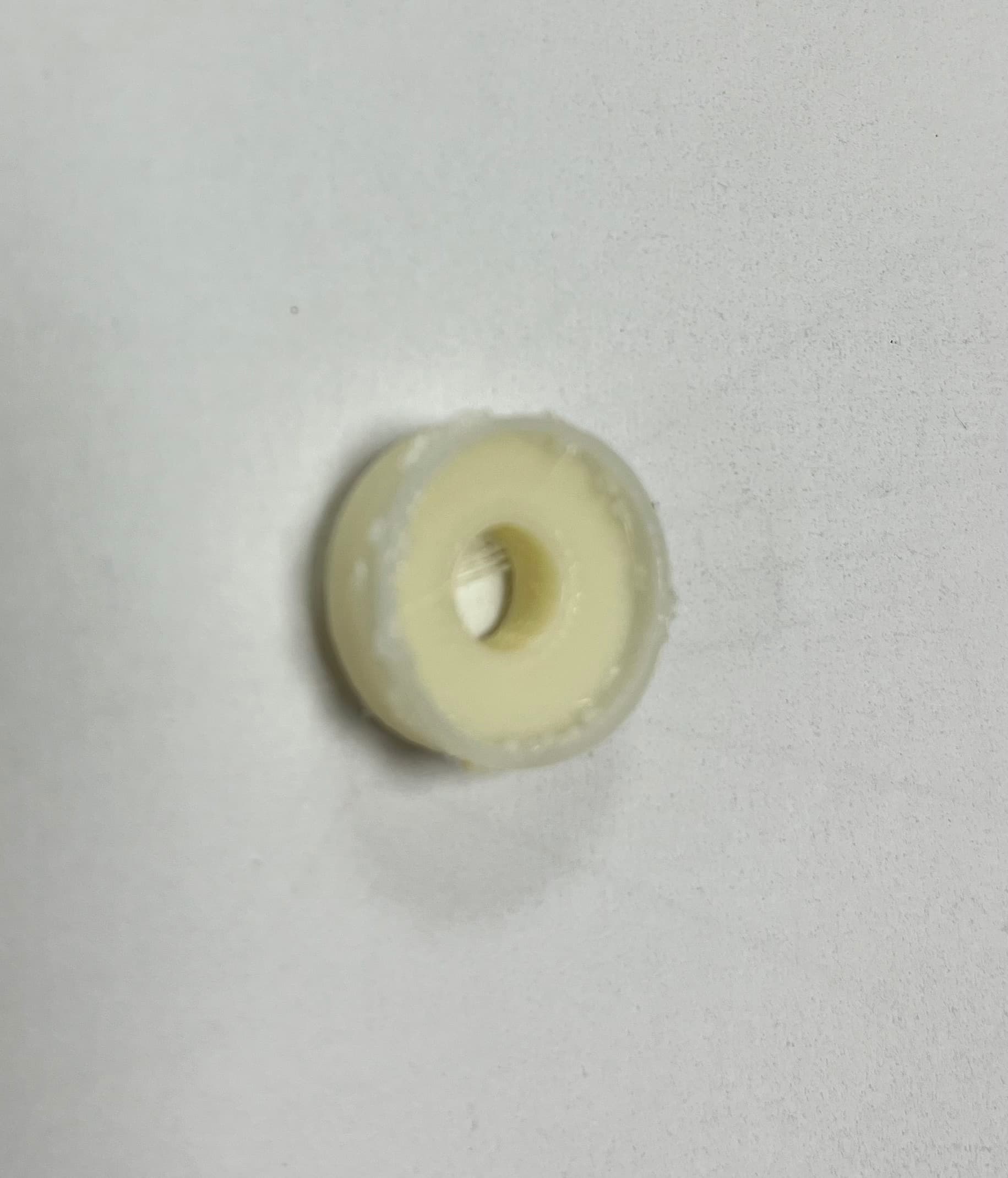

I can’t print good surface with seam. I don’t want use it. Especially I can’t print circles. Because When I print like that My diameter and surface so much bad.

I use 2.32.0.0 version.You can see below my files:
18 Ø ateq-Gövd-Gövde.stl (78.3 KB)
I have a zortrax m300 and I use Z-ultrat filament.
thank you for the file.
Actually this is not seam’s fault (you can always set random instead of normal one), the model is overheated. As for Z-SUITE settings - while printing such small objects (separately), it is recommended to increase the fan speed (100%). However, I am afraid that one of consumable parts might be worn-out. When was the last time you replaced the heater&thermocouple and hotend V2? Their approximate lifespan is 350/400 hours so it might be high time to replace them. Moreover,run the fan test to ensure fan coolers are operational. Overheating will also affect the model’s diameter and accuracy.

It had not changed before. How can I purchase these parts? Because I live in Turkey.And I mostly run at 100% fan speed.Btw Can I assembly hotend v3 .
the hotend V3 is not compatible with the M200/M300 (due to differences in printing profiles - the quality of print may deteriorate instead). Your local reseller - POLİGON MÜHENDİSLİK should have spare parts in stock. You can also contact us directly via email.
