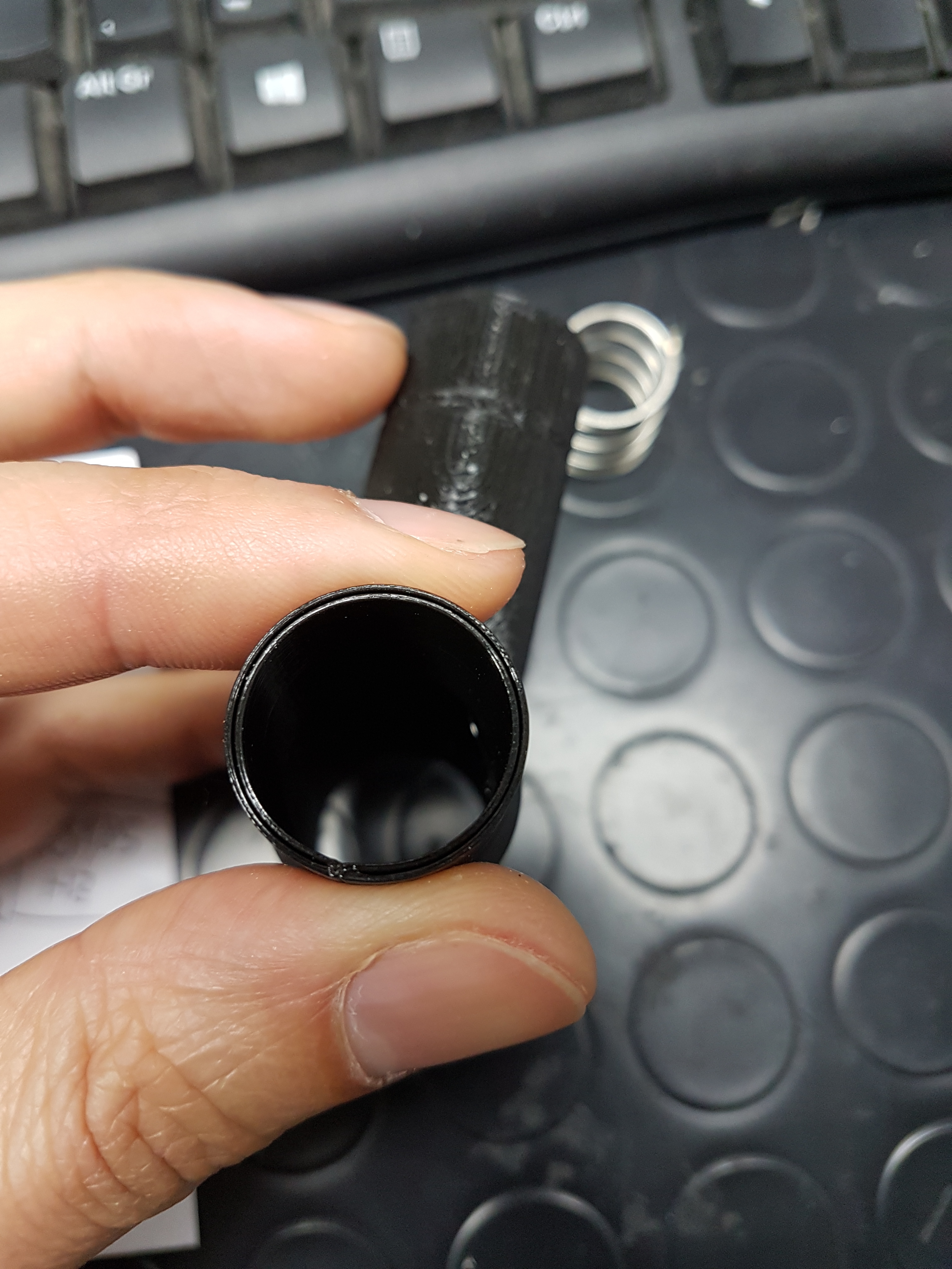

Hi to the whole group, I have a problem with a file, practically the internal and external walls are not joined.
Even if I select 100% fullness, the walls are separated both by program and on the piece. how can i solve?Dave Valve.stl (1.9 MB)

what is the gap infill setting? now I’m using the beta version which allows me to create supports only from the plan unlike the other versions. I attach photos

I am sorry for misleading you and not being clear enough. I spoke with our specialists and the parameter allows to change the space between outer contours of a model and outer contours of infill, whereas in your model - there is no infill. It seems the model was designed in such a way, so there is no parameter in Z-SUITE which could improve the final result.
very very bad … a big problem in case there are thin walls like in this case. I hope that in future releases it will be improved
