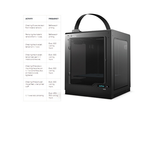

If greasing helped and you’re not facing any other issue, there’s no need for going through the whole axes maintenance procedure. However, please verify if the tension of the belts is ok and there’s no problem with moving the extruder head manually when the device is turned off.
Probably the rails got dry. That’s all. Please make sure you lubricate them every 400 hrs as it’s recommended in the maintenance guide:
