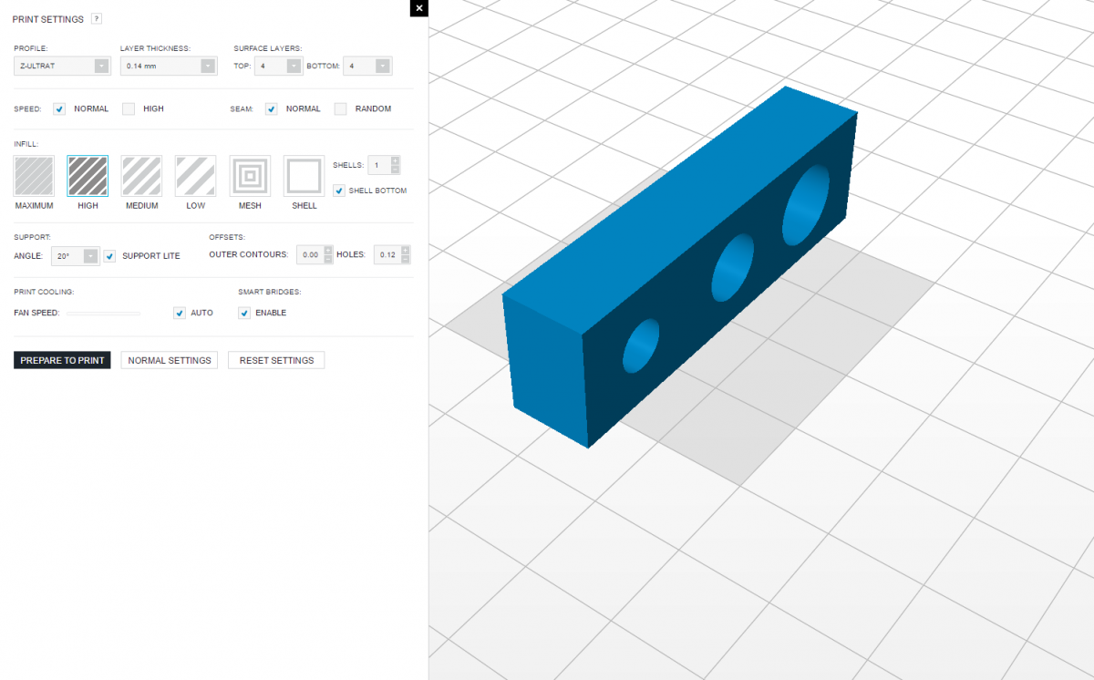

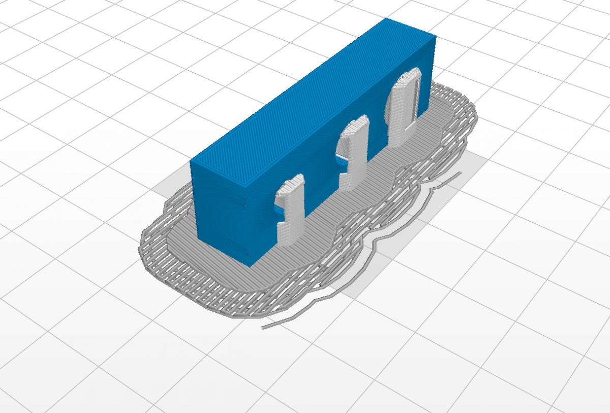

It seems that the smart bridge option with the last version of z-suite (1.6.1) doesn't work; For holes with diameter under 8mm , software add support.
The left hole has a 6mm diameter, 8mm for the center one and 10mm for the right one.
3604
3605
Thanks in advance

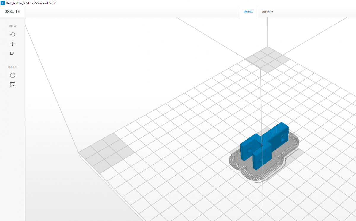

Hi Marcin,
This bug seems to appear with Z-Suite 1.6.1 as it work well with Z-Suite V1.5.0.2.
