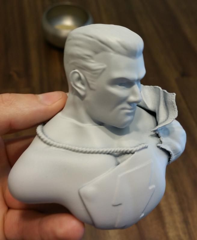

Here is one of a series of models that I'am currently working with a designer on.
This was only a 30 second acetone bath and required only light sanding on the very top of the head. I shot
the model with a coat of primer so you can see the details.

You're correct...it smoothes details, but on bigger models it's not bad.
