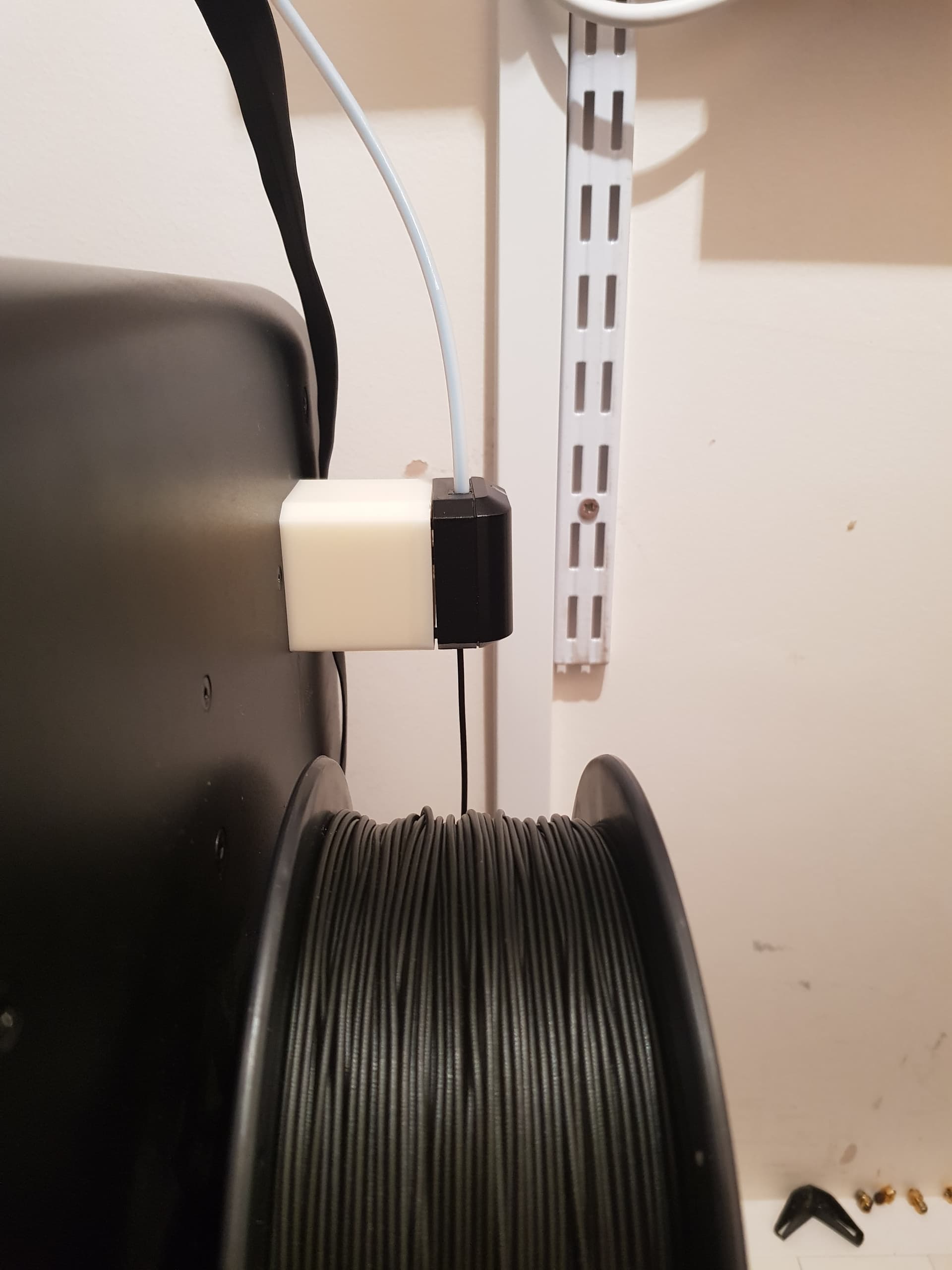

I tried printing with Z-flex and part way through the raft the filament feed seemed to dry up. I checked the internet and there were articles with the same issue but they focused on the print settings and mechanical failures in the feed sprocket.
Flexible material needs a very smooth feed from the spool due to its high friction especially around any even shallow corners.
The following are all necessary to improve reliability of the filament feed.
Where the guide tube fits (m200+) into the filament out sensor and the print head it was being compressed
a. Use a 9/64th drill bit (3.4mm) to relieve the inside of the tube simply twisting it with your fingers in about 10mm
The angle the filament as it comes off the spool is critical as it goes into the filament sensor.
a. A 35mm spacer was fitted under the sensor to move the feed alignment to the centre of the reel. This halved the angle when the filament was coming from the outside edge of the reel.
There is a spool holder for Z-flex on the Zortrax site but
a. It needs to be printed in nylon for very low friction, especially when the spool is full and at max weight.
b. The vertical height should be extended by approx. 70mm (lower the spool) which again reduces the angle from the reel to the filament sensor.
The clips that hold the feed tube to the print head ribbon need to be minimal
The result, a more reliable feed although it will never be as smooth as hard filaments.
