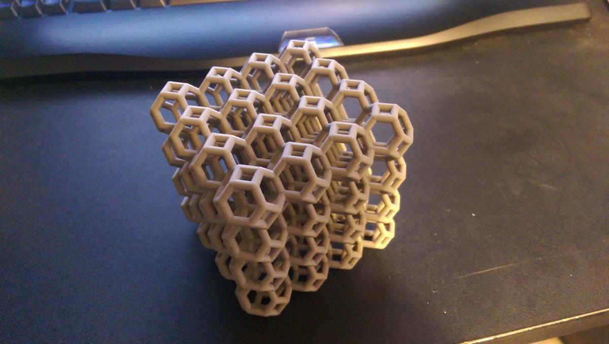

I decided to print up this model on the Zortrax, with no support and solid infill 16 hours in total print time. Overhang control is good however the printer seems to have added a few stray lines for whatever reason, nothing I can not clean up.

Awesome, nice job, did it worked at the first attempt?
first try no set up needed.
Wow, that's awesome. Material and settings?
Cool Grey ZABS
.14, Full infill, Support Angle Disabled.
Speed: normal. print time 16 hours, post processing time 0.
Here is a better picture of the model, sorry for the poor quality of the last few, my room is quite dark and the phone camera is not great in low light.
