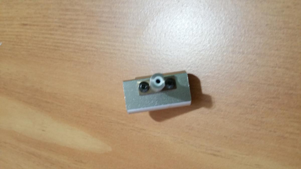

Anyhow, here are the hotends I have.
This is the one that was on my M200 when I got it last month:
3166
3167
3168
And the one I've been using since day one:
3169
3170
They are both V2 hotends.
