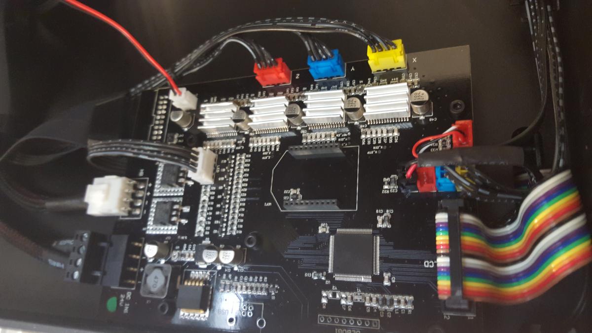

Yeah...in the video itself it looks more like an empty socket...with the outline visible on the mainboard.
But a better pic would definitely help.

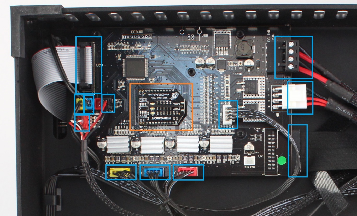

I just purchased my M200 and it's missing the WiFi module, This tells me that Zortrax had no intention in adding the WiFi. Now it make sense, the module that they originally had was never going to work. I use those for my robots and they are very slow, these modules can transfer up to 46KB per sec, my last print was 12.5MB that would take about 5 Minutes to transfer. I think I will need a big discount on my new machine. I think it's time that Zortrax come clean with the WiFi issue, they have not being truthful with us.
I want to hear from Zortrax and explain this to us. Its time, the cat is out of the bag.
I believe based on a picture that I seen on the web, that they used this module:
http://www.dfrobot.com/wiki/index.php/WiFi_Bee_V1.0_(SKU:TEL0067)
http://support.zortrax.com/wp-content/uploads/2015/05/Mainboard-replacement-4.jpg
