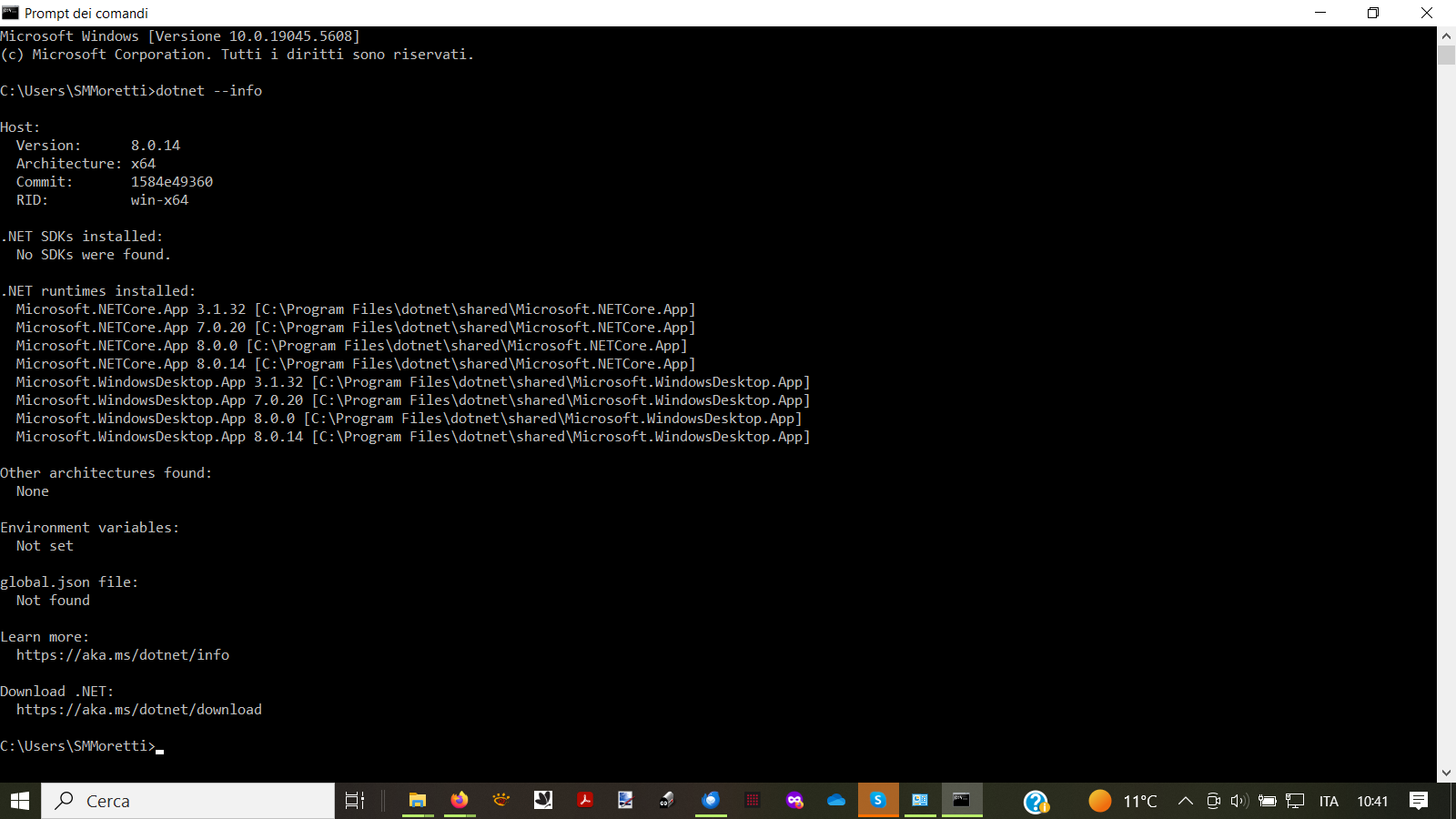

First, open your Command line and type
dotnet --info
Paste the output here

Hmm, it seems to be alright…
Just so we can eliminate any uncertainty, try to install a .NET Runtime again.
Could you also try to get logs from Event Viewer.
