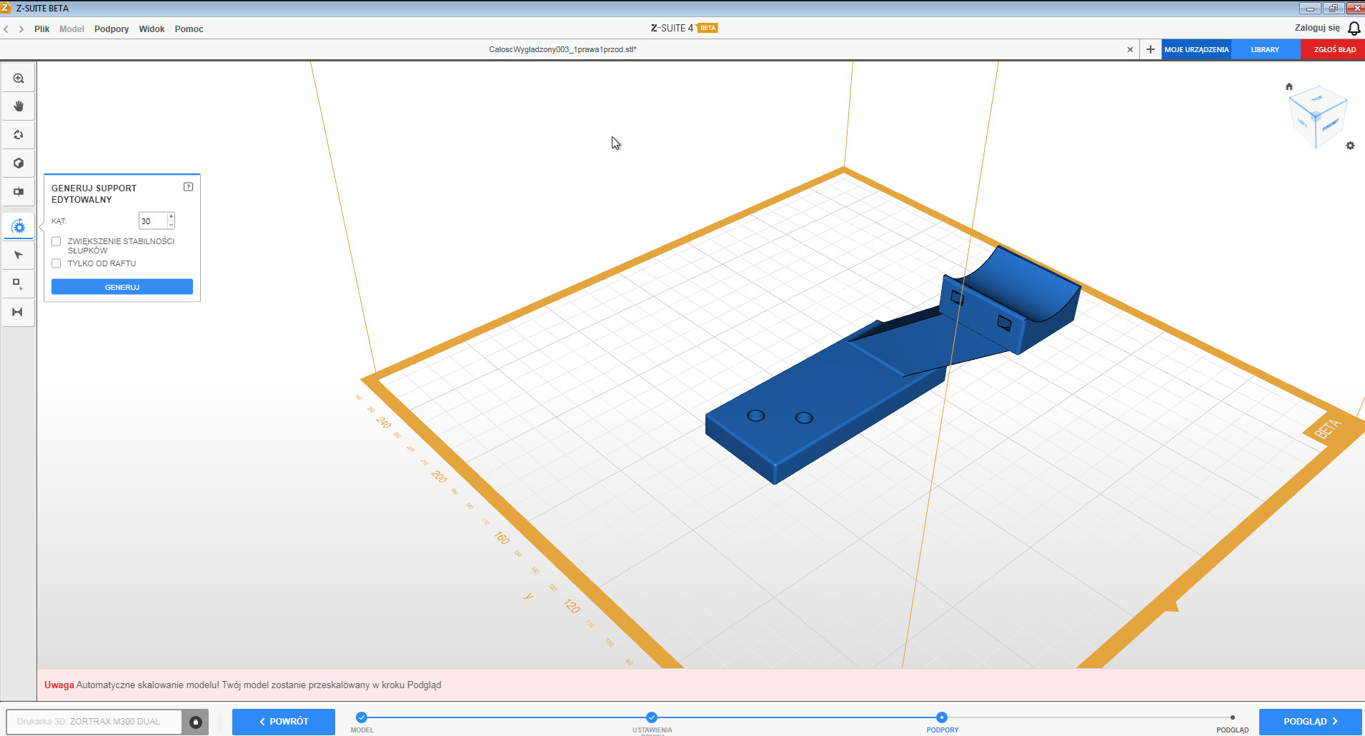

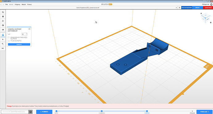

I have a Zortrax M200 Plus, hardware 2, firmware 2.6.16. I am runing Zsuite on a Windows 10 Pro x64 ver. 22H2 with a Intel Core i5, 12G RAM, SSD.
Why I get a message “Automatyczne sklaowanie modelu…” (Automatic scaling…) after clicking button “podpory” to generate supports. The model is much smaller than printer area.
Does it mean that Z-Suite will make the part useless by scaling it?
The message disappear after rotation of the model.
