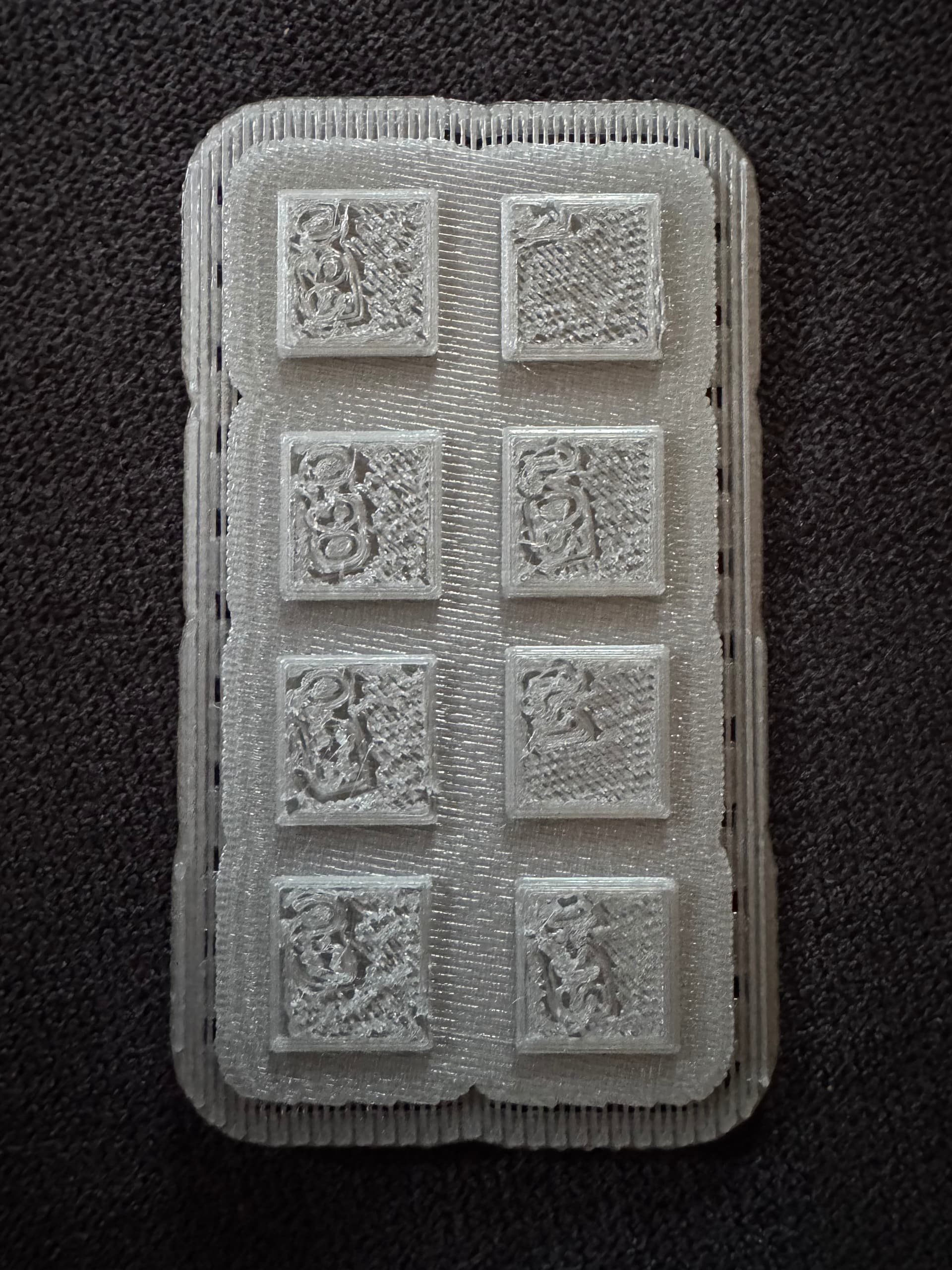

I got very bad print quality with underexstrusion with the new Z-Suit.
The raft seems to look normal.Also the sets which different parameters. seems to have influence. But the parts itself look very bad.
Flow_Calibration_Matrix.3mf.zprojx.zprojx (53.9 KB)
Flow_Calibration_Matrix.3mf.zprojx.zcodex2 (123.5 KB)

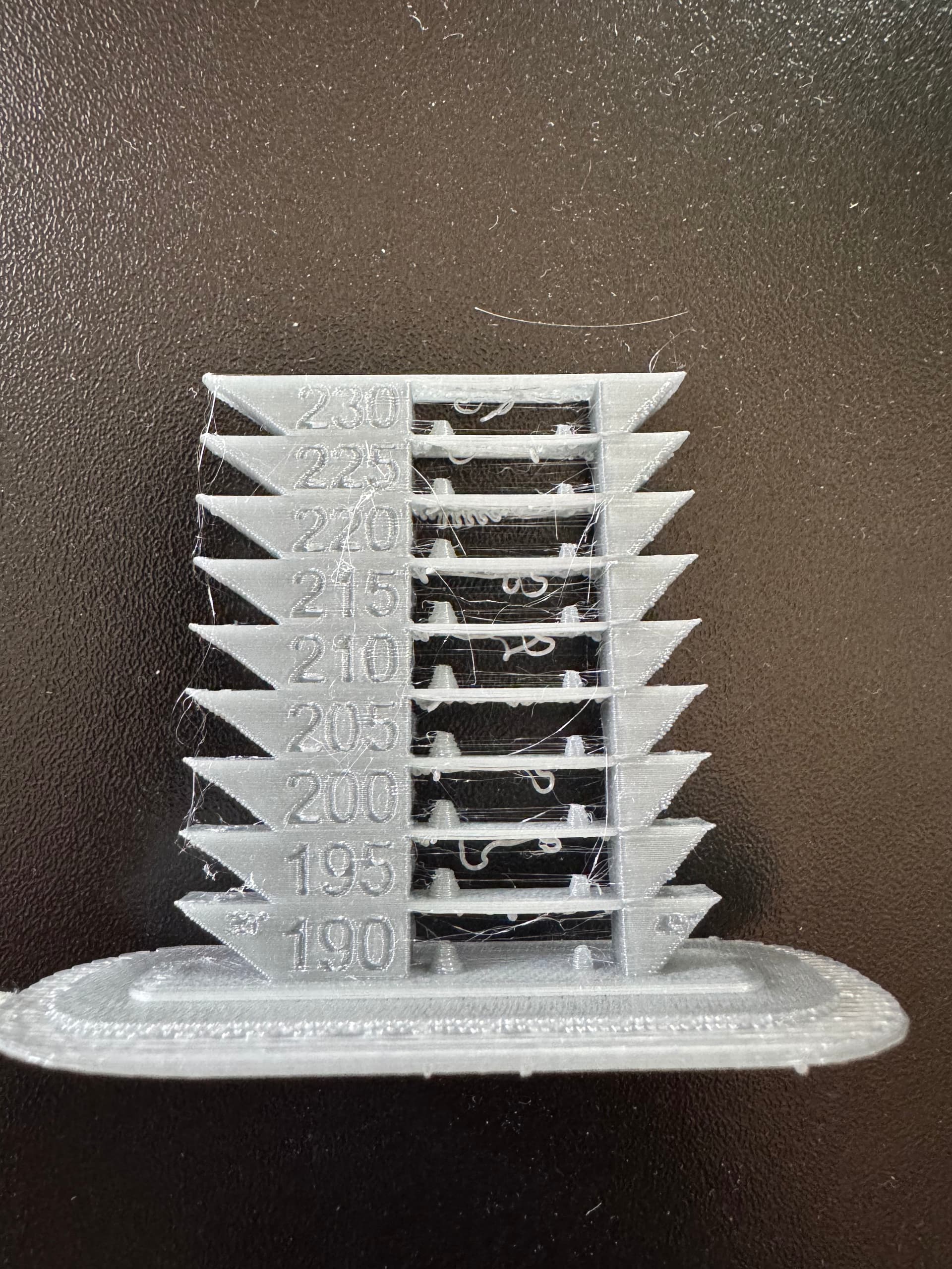

Also on another print I got some issues.
I thing the sets didn’t made a change.
In this printed heat tower temperature changes should have been applied. But it doesn’t seems to work.
Temp_Tower_PLA.zprojx.zprojx (588.6 KB)
Temp_Tower_PLA.zprojx.zcodex2 (466.8 KB)
