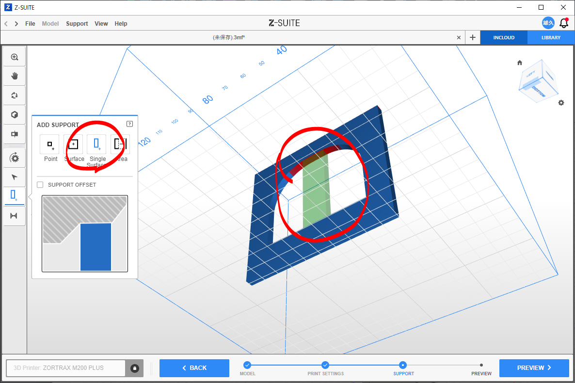

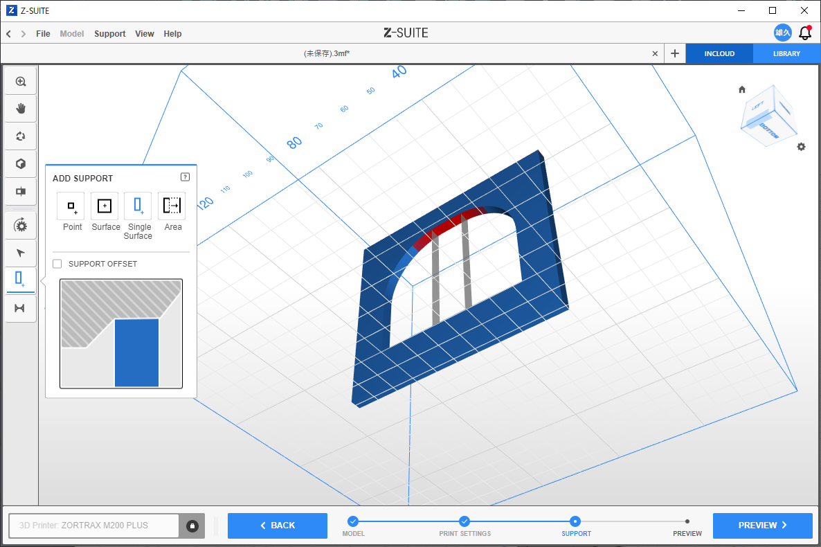

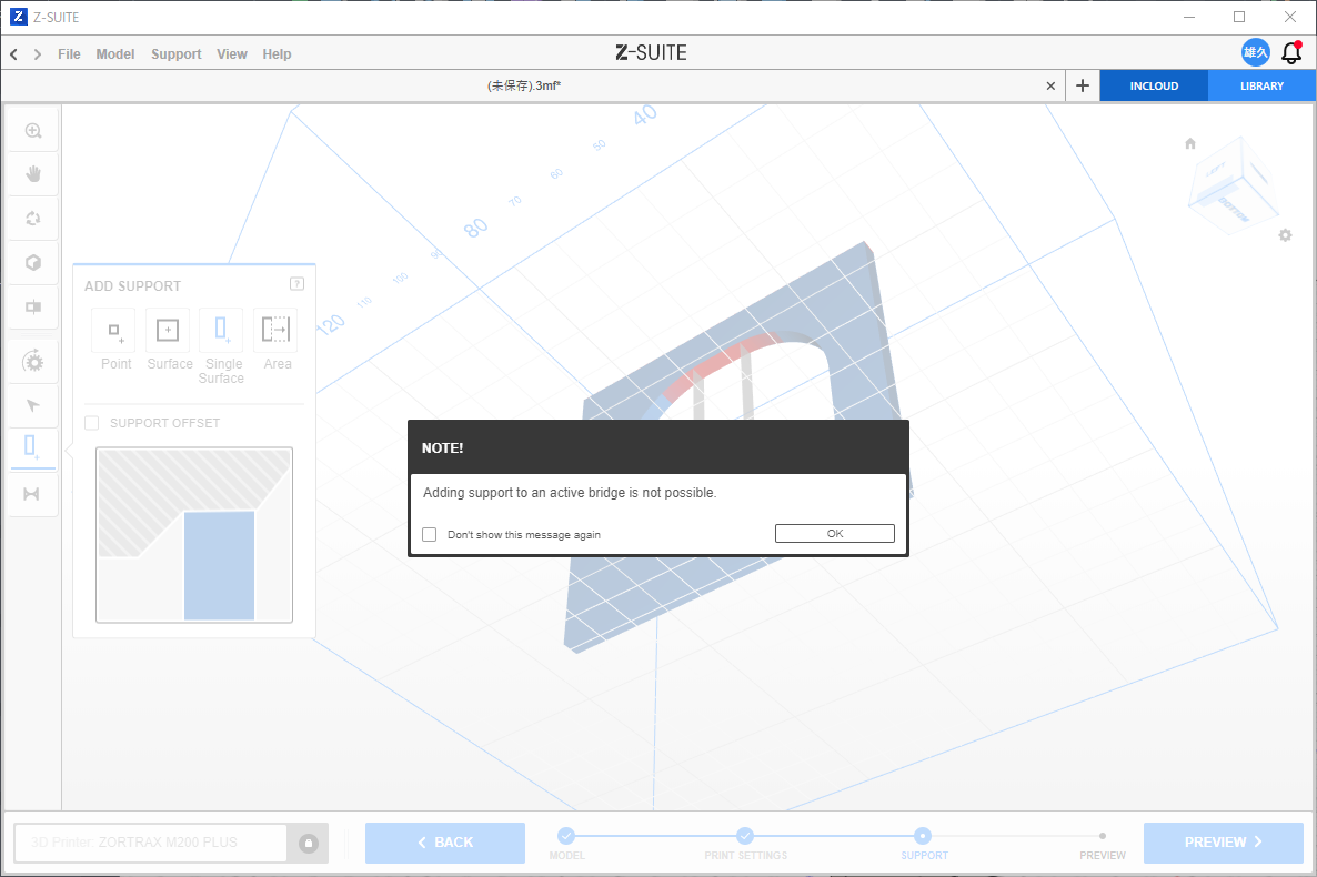

When I try to add support to a flat ceiling of an arch,
I get the warning:
“Adding support to an active bridge is not possible.”
and the support is not added correctly.
This issue has been occurring since quite a while ago, and there seems to be no sign of improvement.
It also happens in version 3.6.0.0.
(Furthermore, the “Don’t show this message again.” checkbox is not remembered.)

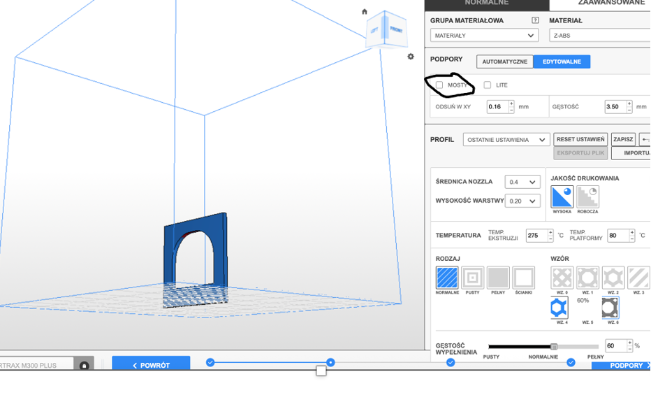

Cześć. Przetestowałem twój model i teraz widzę, że powinieneś odznaczyć opcję mostów w krajalnicy w ustawieniach zaawansowanych. To wygenerowało wsparcie dla mnie bez żadnych problemów i było w porządku. Wysyłam ci zrzut ekranu . Pozdrawiam
It’s true! Amazing! Thank you!
The problem was solved by unchecking the “Smart Bridge” checkbox.
(The “Active Bridge” warning still appears, but that’s a minor issue.)
I reread the description for Smart Bridge.
I understood that it’s a feature to omit supports for short bridges, but 10 mm is far too long a distance—support is clearly necessary there.
