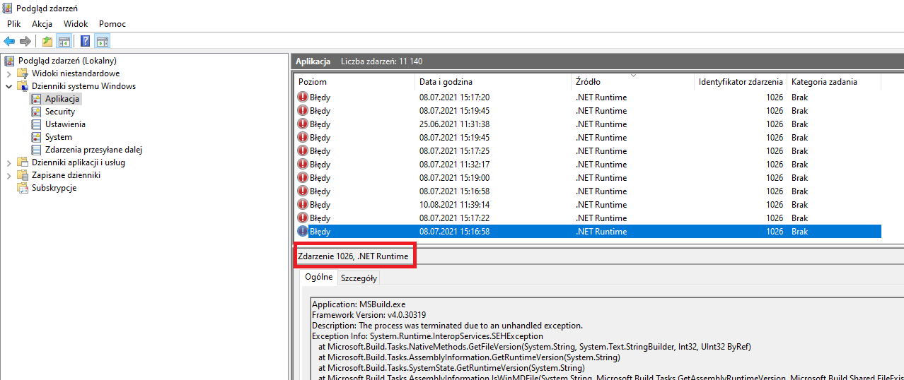

Hello Guillaume,
Please go to Even Viewer and click on the “Application” folder. Take a screenshot of the errors that have Z-SUITE in its name. Also, check if you have any report concerning .NET Runtime:

Here is what I have found :
The only Zortrax related error is aged from many month before my problem has occured. The few errors from .NET that has occured this last few days are related to thunderbolt.exe . Nothing seems to have to do with Z-Suite.
