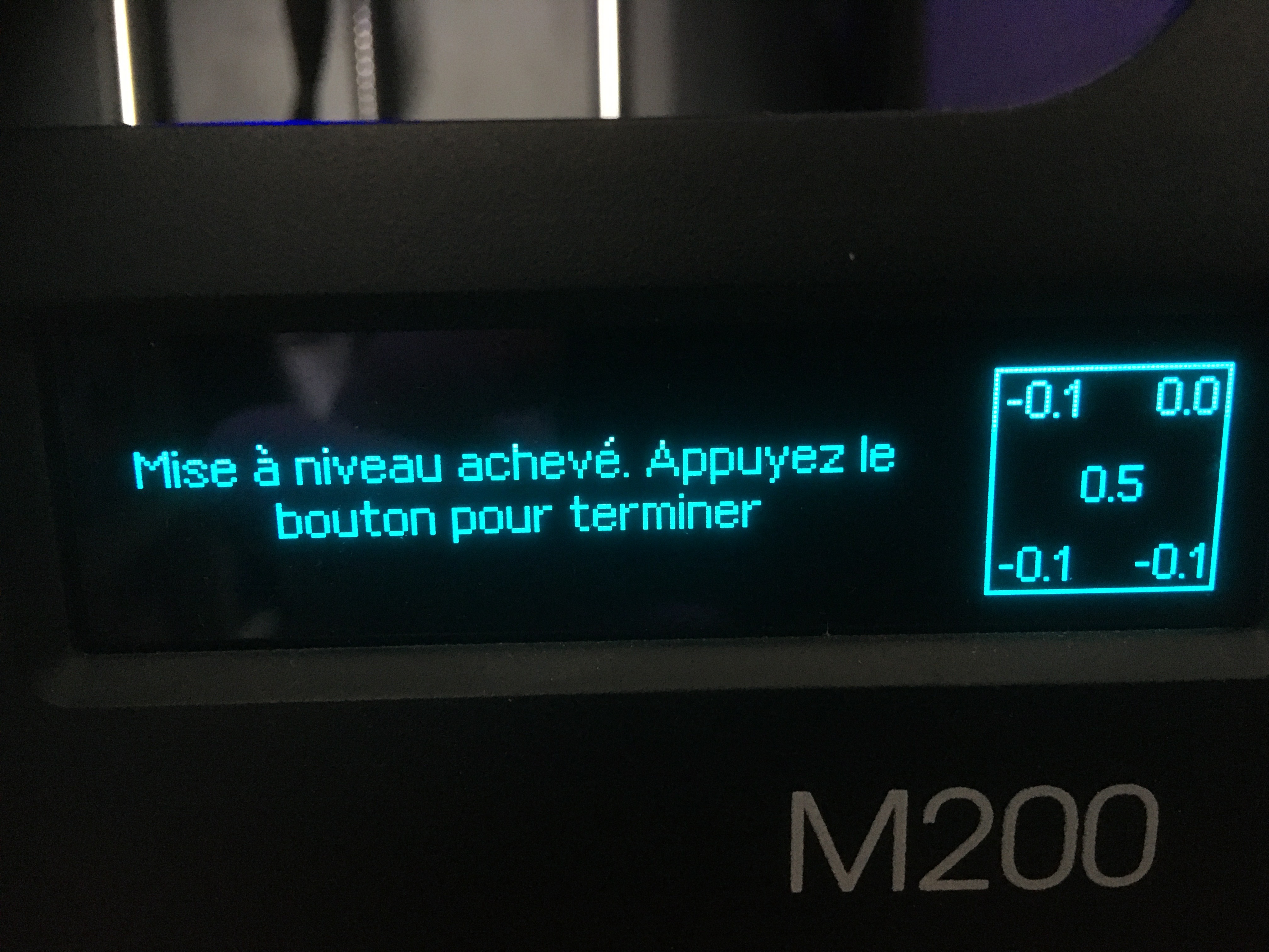

What are the autocalibration results? The platform might require maintenance, or even replacement if it is bent/deformed (it is a consumable part - its approximate lifespan is 700 hours).
the plate adhesives - I would recommend Z-ABS juice (that was alredy mentioned in the manual I sent you), or even a glue stick.
As for autocalibratiton results - the center point value is 0.5, wheras most of the side points value is -0.1 - this difference is too big, it seems the center of the platform is deformed. If the maintenance does not resolve this - the platform might need replacement.
