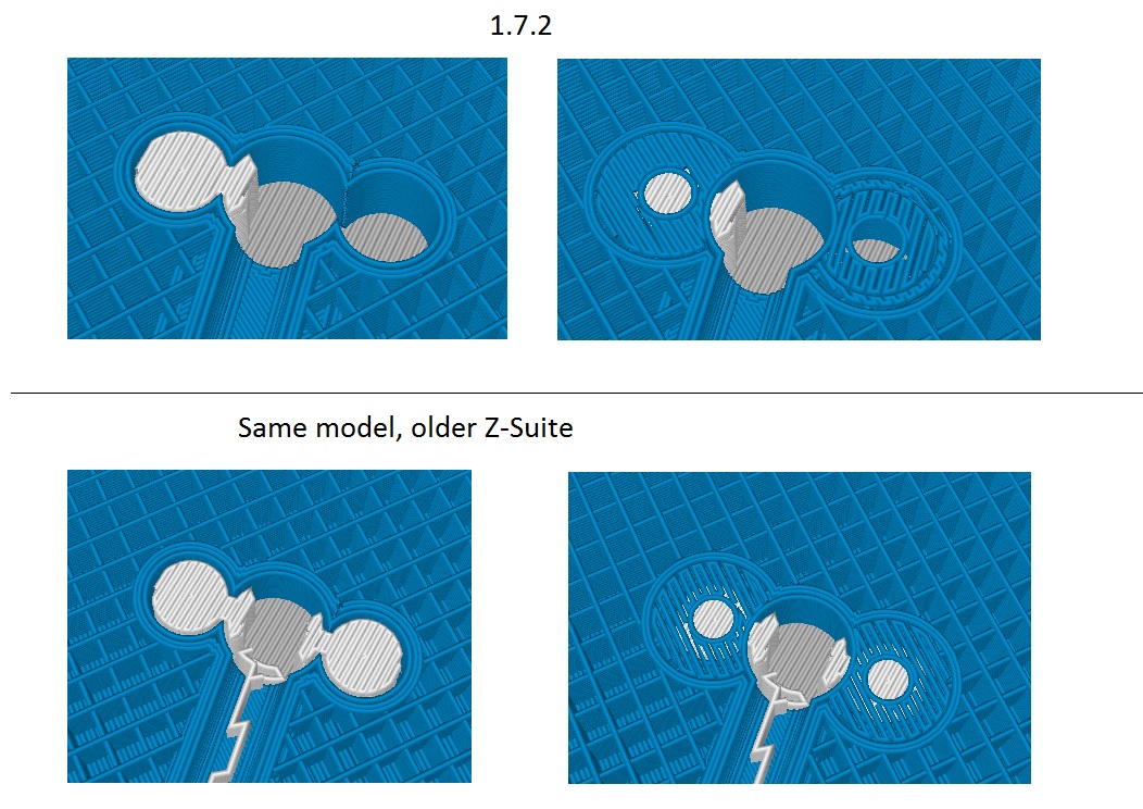

It is visible at zsuite preview also.

and just reminder.. there is still support generation bug. I wonder if you are doing something about it. Why it is not fixed yet? Support worked great before 1.7. Why don't you just restore it from earlier version?

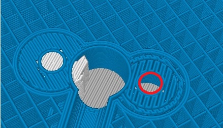

If support has been fixed can you tell me why it still generates it wrong like on a picture? In previous versions at same 3d model was ok.
Try turning off Smart Bridge
Ok, but don't think it should be ok with smart bridge too? These holes are identical so why on one hole there is support and there isn't at second?
Smart bridge eliminates  support on horizontal hole which dosn't need it. Also I'm sure that at more complex geometry there are bugs like this too.
Smart Bridges has a limit of ~8mm dia.  Both c'bores are ~8mm. This puts the c'bores on the 'edge' of Smart Bridge
If you scale the part to 90%, both c'bores are now less than 8mm, smart bridges works for both.
If you scale the part to 110%, the c'bores are now over 8mm, smart bridges turns off.

Still it's a bug because it prints round ring in the air (red color on picture) before it make a bridge. So it shouldn't make bridges for holes like these even if Smart Bridges are on for other parts of the model.
