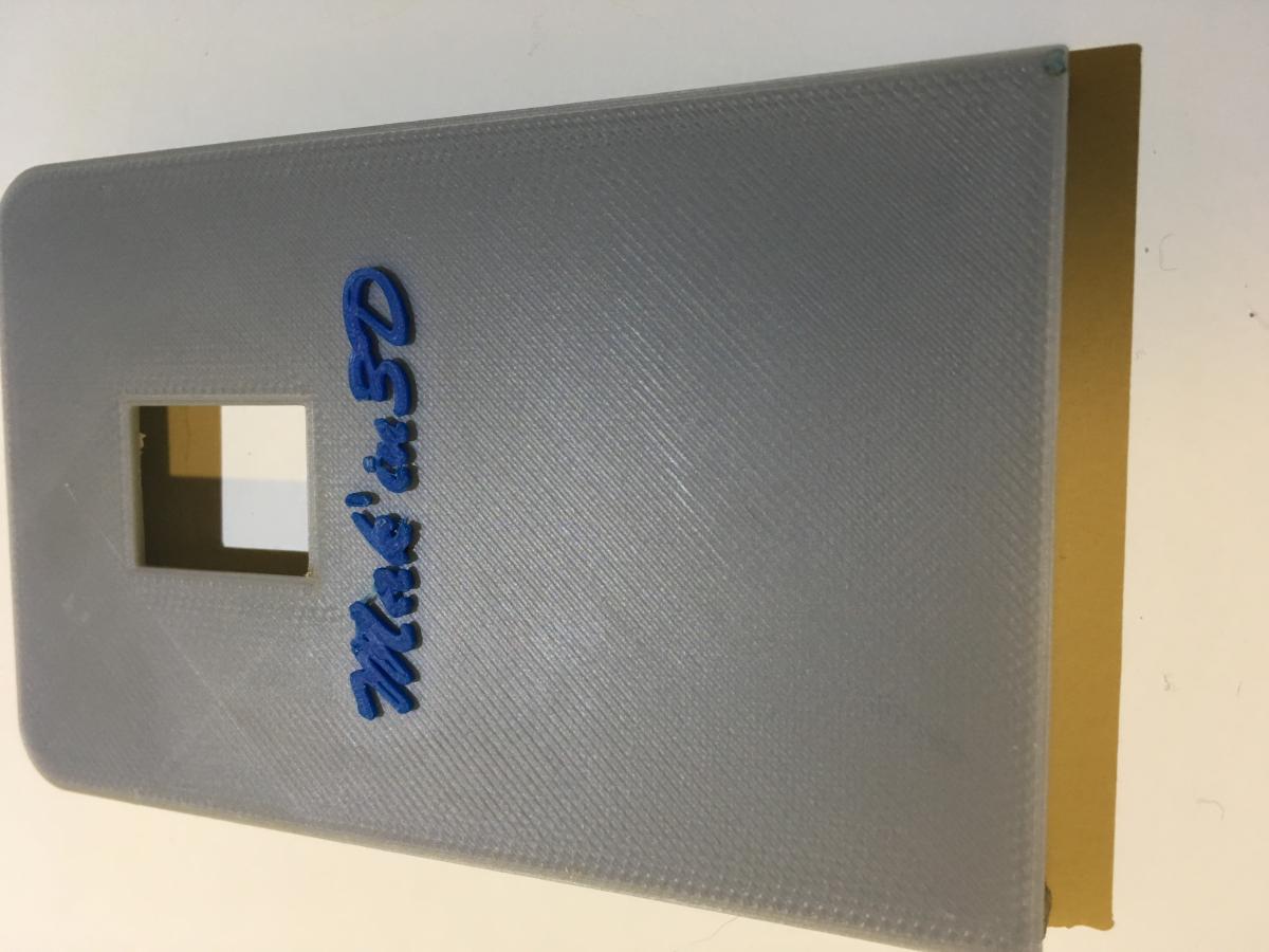

Hello!
Problem support creation
A finish not smooths above, because a long surface not support, i believe…
the separate components of a .zcode preview, it’s very good :slight_smile:
Picture 2 : ZSuite 1.7.2.1
Picture 1 and 3 : Zsuite 1.8  Useless to continue the printing of the second color.
Sorry, English not so nice
4013
4014
4011
