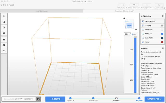

I wanted to report that on Mac I encountered this small Bug.
When the program loads the preview of the piece to be printed, with the work window open by default when the program is opened, the loading of the preview is not displayed if not layer by layer.
if, on the other hand, I open a new work window, the preview with the relative supports is loaded correctly and is displayed in its entirety.
